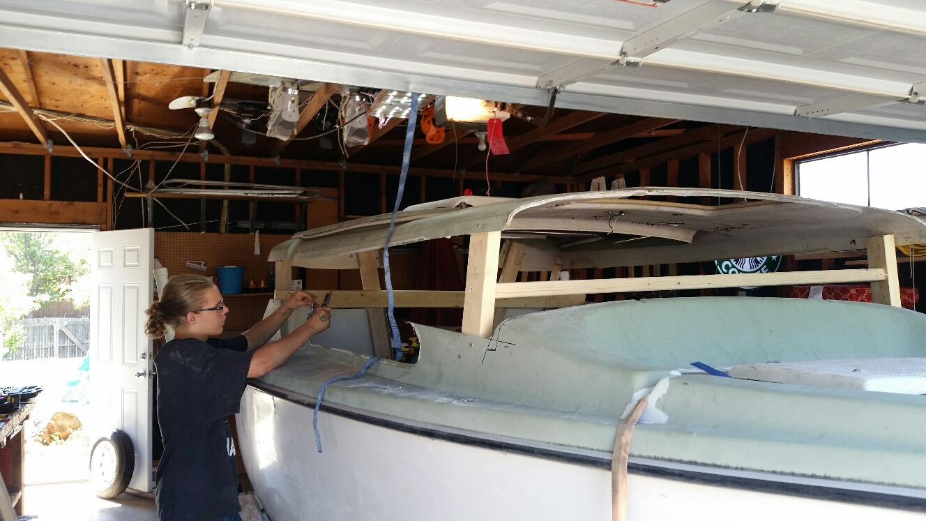

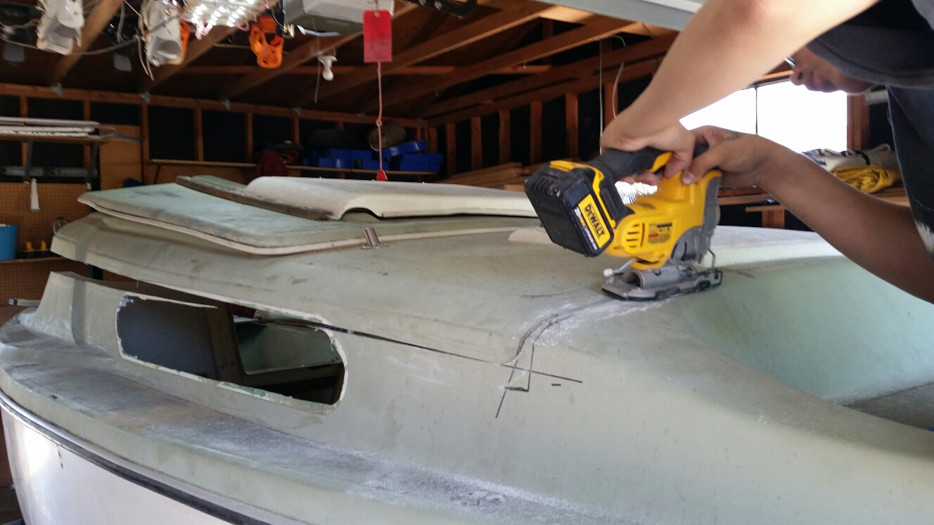

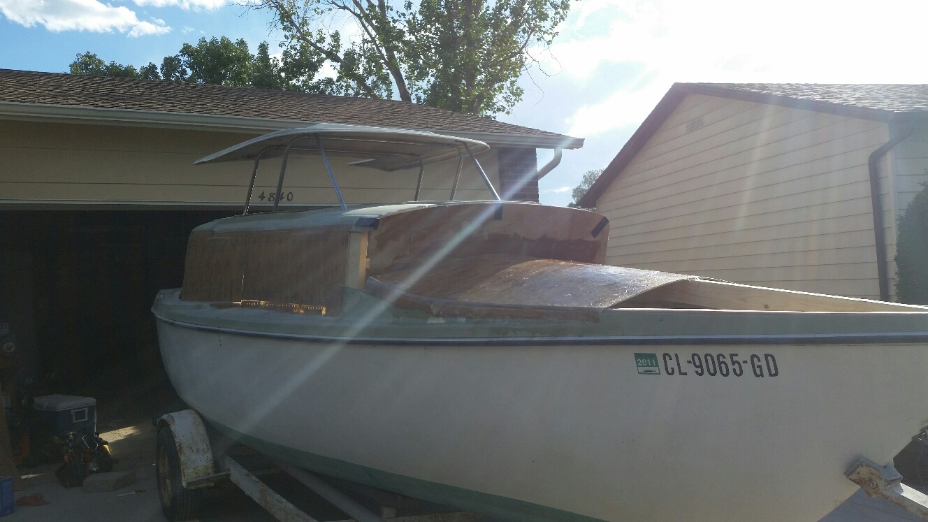

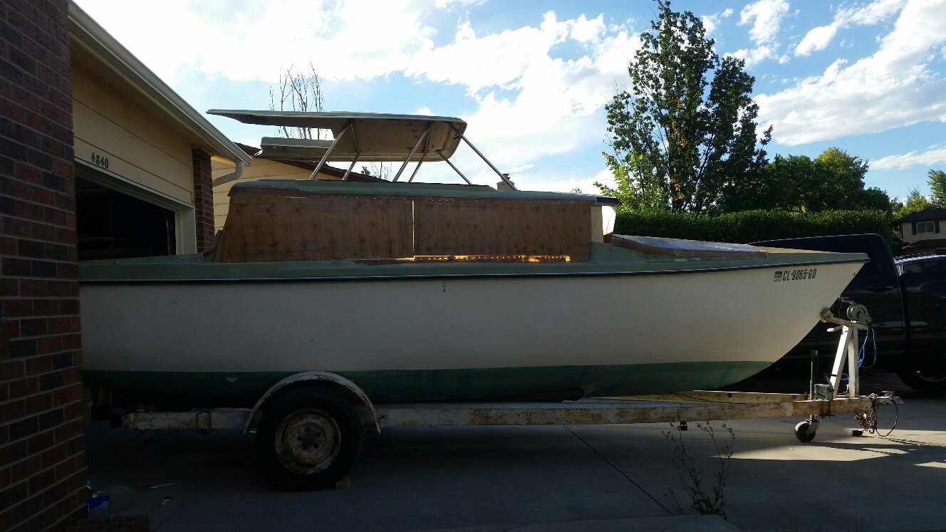

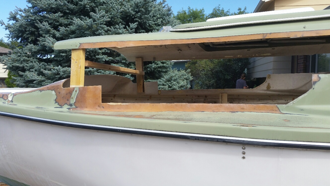

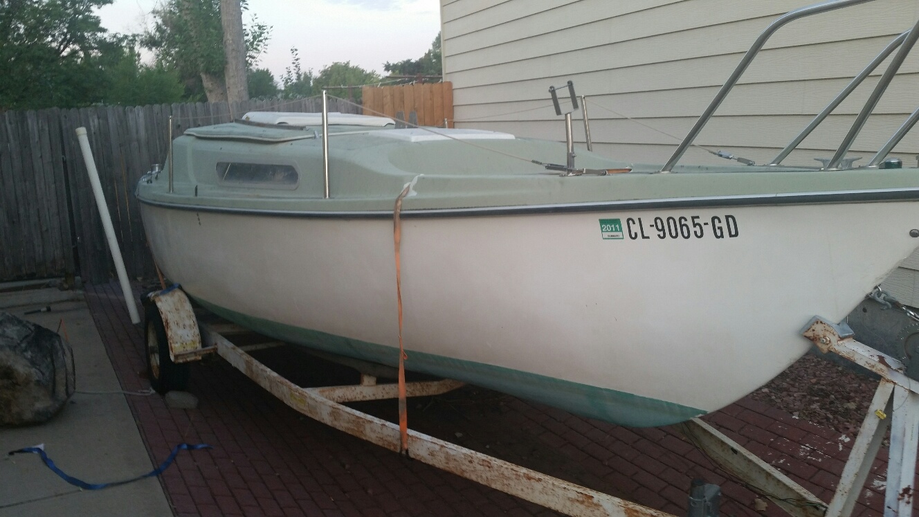

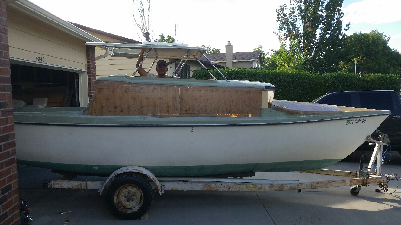

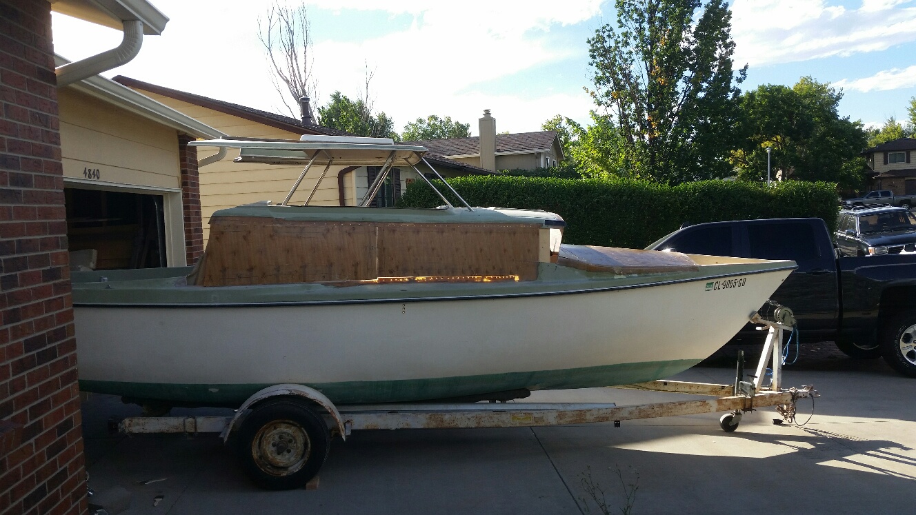

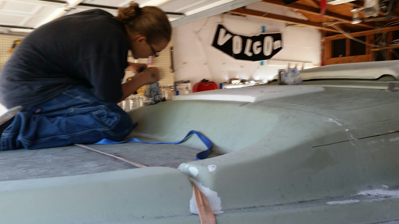

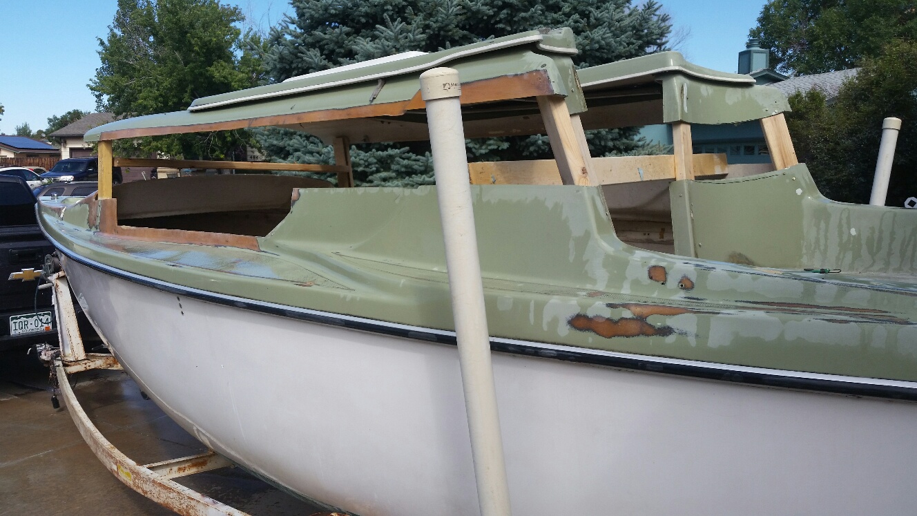

here is some of the work that has been done so far.

You'll need a new compression post under the mast step. Otherwise your probably ok.
One thing to watch as you redesign the boat. By lifting the mast you'll need new standing rigging since the old ones will now be too short. Also, by lifting the sail plan you have moved the center of gravity(cg) of each sail and thus the righting moment will be different. If you always sail with a heavy boat (the whole famil) probably no big deal however, if you are short handed with out a redesign of the sail plan she'll most likely be pretty tender and tend to heal more than normal.
Interesting project, and after some of the other disasters people have brought back to life it will be interesting to see your progress.
Good luck and fair winds
