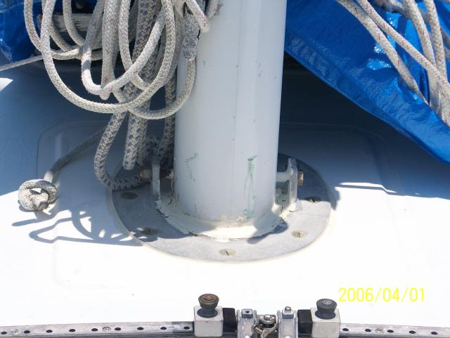

re bolt through the mast
Yes I have one too. Mine looks similar to the picture, except I have a marine plywood ring on top of the steel mast collar. The included picture was from last years launch. The hole is covered but you can see that its raised up 1 inch from the deck.
When I raised the mast, the marina crew spent 30 minutes trying to put that bolt in. I finally suggested they tighten the stays. Then it slipped in easy 8^)
I wanted to put a better mast collar on, you know, with holes for pulleys etc. But I was just thinking that you could put something on either side of the bolt to do the same thing, and you wouldnt need to modify whats already there.

A question for all of you, do all of your H37c have a bolt going throught at the level of the deck partners, I've heard of it before, but it's the first time I see it. My partner is made to have a through bolt, but the mast was never drilled (maybe the factory forgot, my boat was made in 1981). What is the role of that through bolt ? Should I add one ?
My vang bale is attached to the thru bolt, or the bolt goes through the vang bale on each side of the mast.
