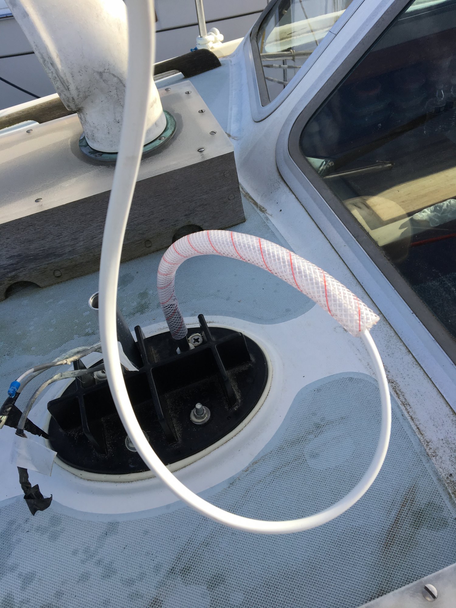

There is an alternative to the Swan Neck tube for wires.
Bent hose.
That is the power cable for lights in the mast. the hose is bent over inside the mast. Less water dripping inside the boat. Water falls on the base and weeps out onto the deck.
Bent hose.
Excellent idea!
I need to run wires through my CC cockpit coaming up to the bimini top for lights and solar

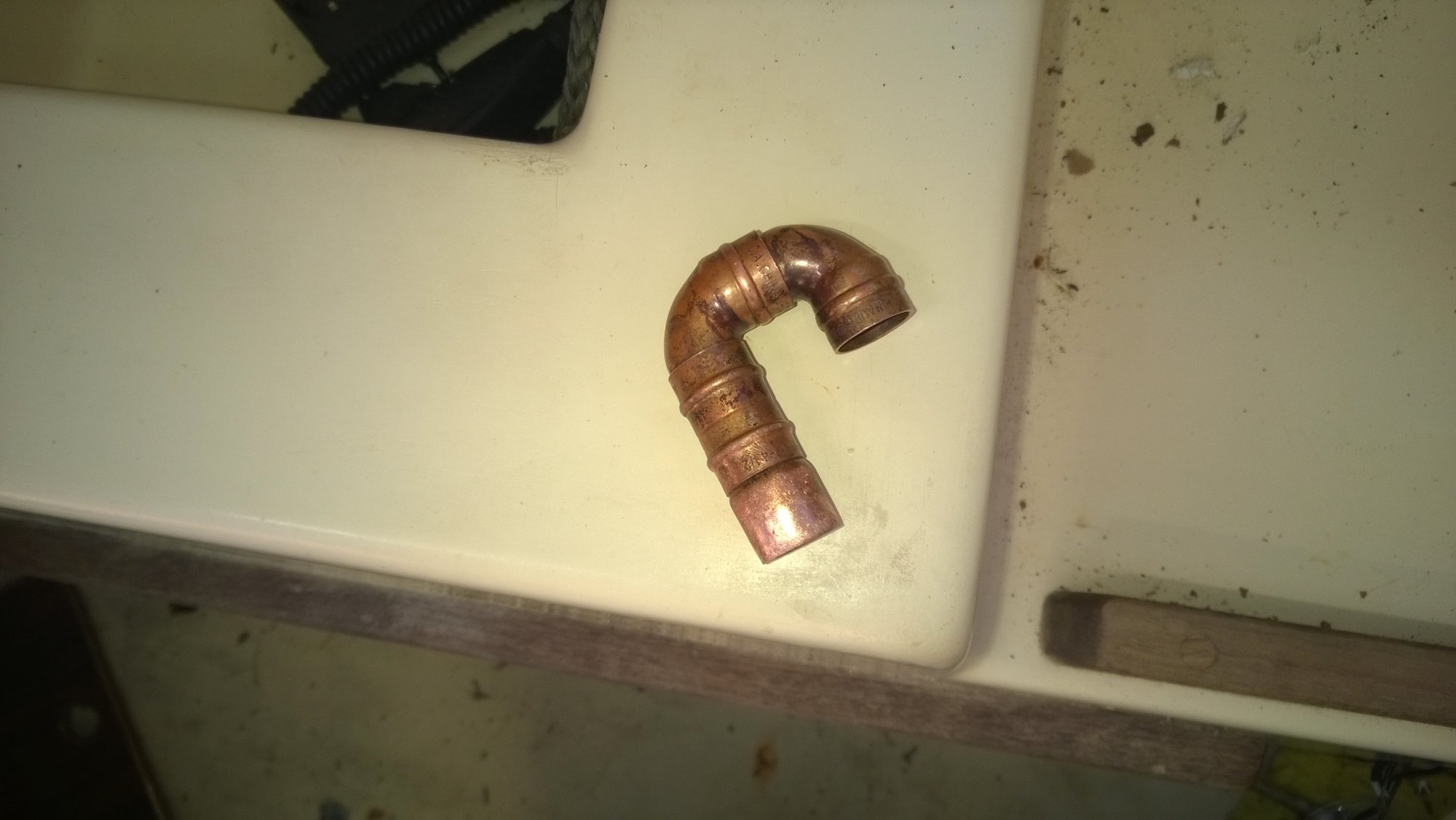

198
Montgomery 17, Venture of Newport, Mirror sailing dinghy, El Toro sailing dinghy Mound, MN -- Lake Minnetonka
Copper plumbing fittings epoxied thru deck.
