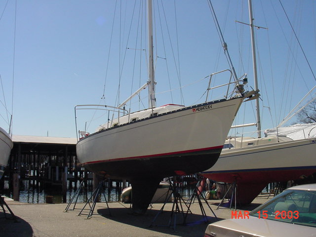

Age old question.....This is the first season hauling my 81' H30 for the Winter. I have asked around the marina, and noticed other boats that have been hauled, it is about 50/50 in opinions, up vs. down. I plan on leaving my mast up for the winter. Some people say leave it up, other say you must take it down. Any comments?

Unless you need work up top, leave it up. The people who fret about taking the mast down on the hards worry that the boat can't give like it does in the water, hence the mast will be shaken. Look around and you'll see that no one else cares, appropriately so.

unless you have work to do on it. Leave the rigging properly tensioned, too. Loosening it will just free the mast to move in the wind. David Lady Lillie

I have left the mast in and taken the mast out. If you have a lot of work to do on the mast take it out, otherwise leave it in. I do differ with Dave, as I suggest you loosen you standing rigging as the first time I was out, I did not. I came back in the spring to indentations on both sides under the rigging. The cold of the Maryland winter contracted the rigging to tighen and stressed out the hull. After that, I have always loosened and not had a problem with the stick coming down or the indentations getting deeper. Good luck Ian s/v Meant to Be.

I stored my last boat for 18 years with the mast up. I am entering my second year with my 356 leaving the mast up. Unless you need to do some maintenance why risk the yard damaging your rigging.
