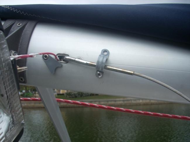

Posted a safety fix for those who step their masts and worry about the mast to shroud and forestay T fittings seating properly. I've tried crap factory plastic tab, rubber inserts that may or may not set right and tie wraps that need to be replaced with every use, but fear no more. $2.50 and 5min will end your concerns. Posted details on the trailer sailor forum here or ck out the pic below. http://www.sailboatowners.com/forums/pviewall.tpl?fno=19&uid=73253242394&SKU=2008088090522.29 To those who've lost a mast to this problem(OMG!) or scared your self(or wife/GF) to death at the ramp post it under "why didn't I do this earlier". Another easy mod well worth your time. Good luck and safer sailing. Michael
