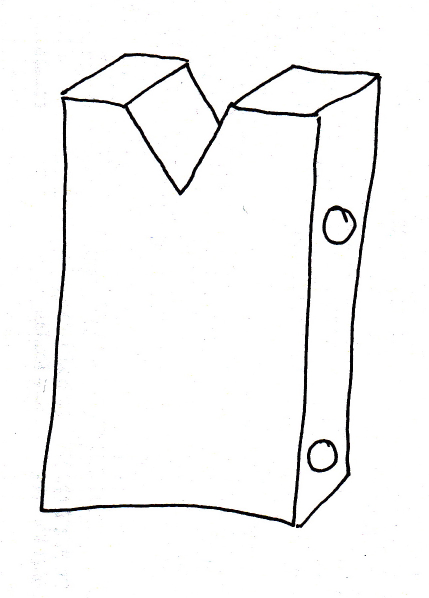

On our 26c, we made a "V" in the end of a 2x4, with two holes as per the attached drawing. The 2x4 bolted to the mast step on the deck, and a length of 1" web strap with a gripper clip on the end was fed through the upper hole and wrapped to the mast, securing it to the 2x4.
Fast, and effective, it wasn't even painted and lasted for 15 years.

Mar 12, 2016
51
Macgregor 26M Local Freshwater Lakes
Simple, Effective. I like simple and effective plus proven over 15 years. I'm going to do it. I'm type A so it will get spar varnish or paint haven't decided which. :)

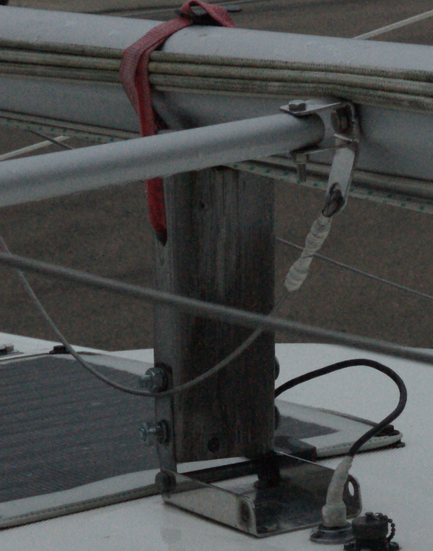

Here's a picture, I missed something. (it's been a couple of years, amazing I even remember owning the boat!) The bolts holding down the tabernacle hit the bottom of the 2x4 and it needs to be raised up a bit, as you can see in the picture, there are two joiner straps from the local lumber supplier, one on each side that are bolted to the 2x4, raising it up a bit. You can also see the red strap wrapped around the mast.

Mar 12, 2016
51
Aside from the clearance issue, I would think it would distribute the up and down loads over more area and make the block last longer which apparently it did, 15 years or so. I have one already made up. I'll see if I cleared the bolt heads and if not, I know the solution. Thank you.
