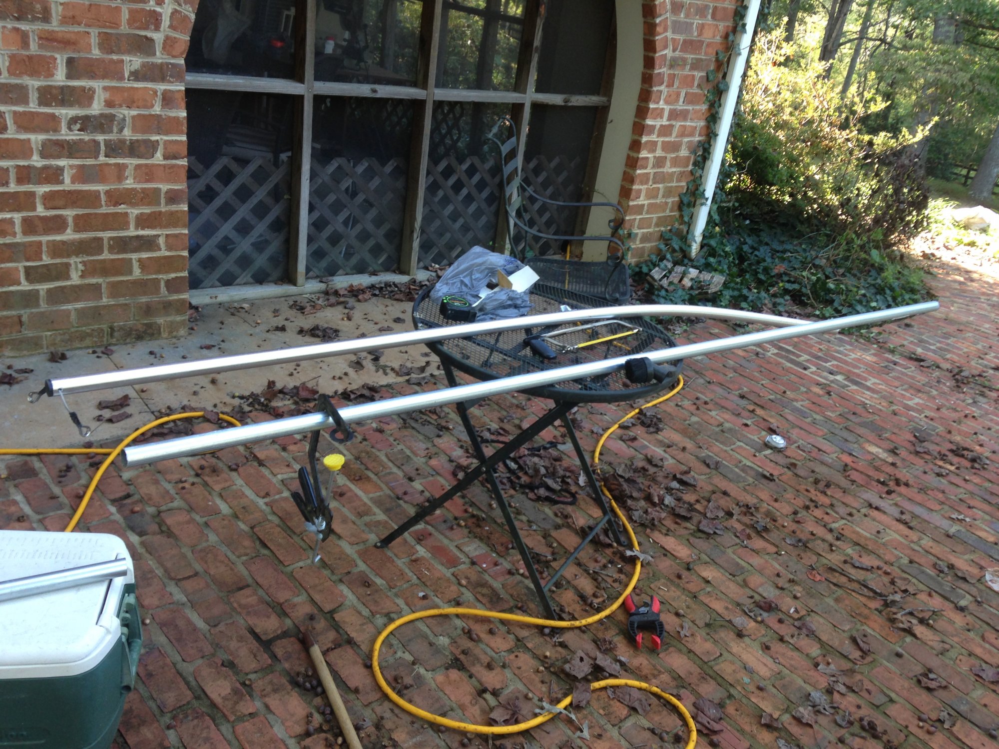

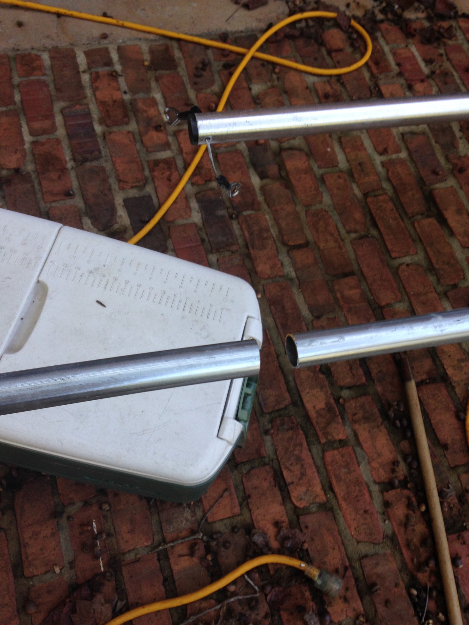

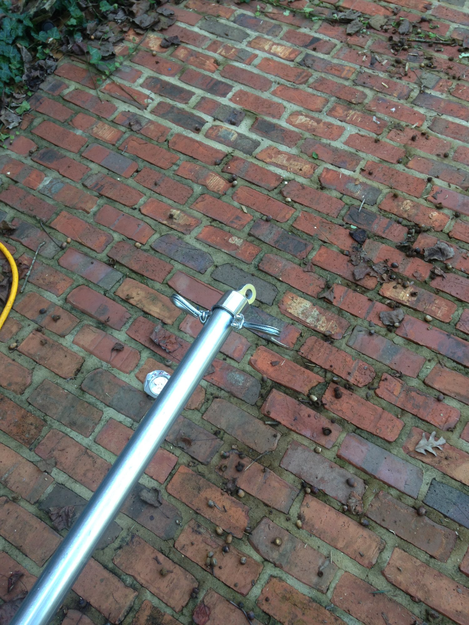

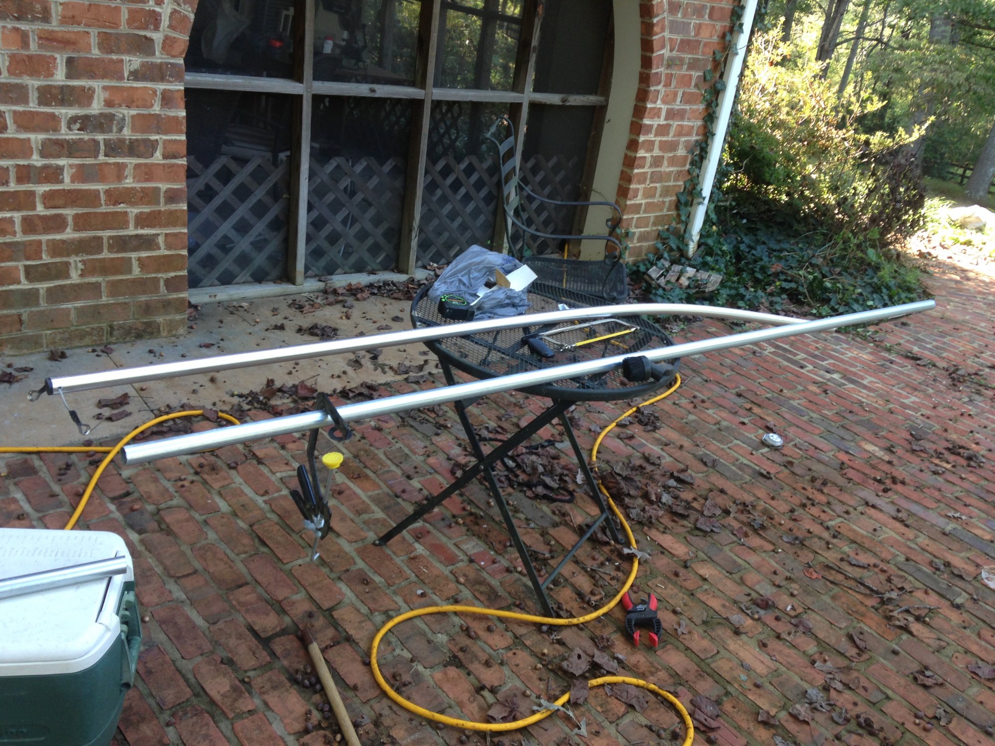

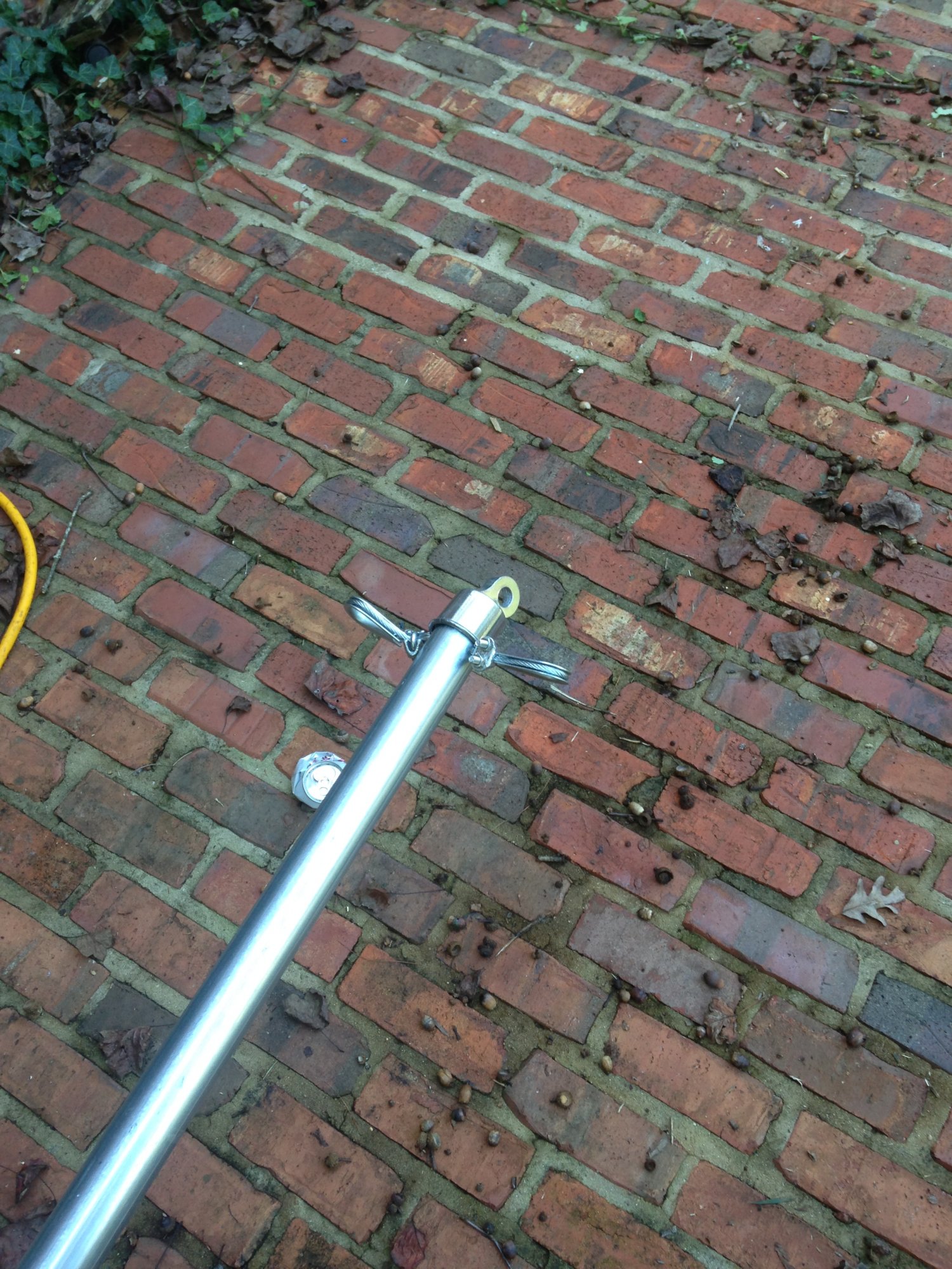

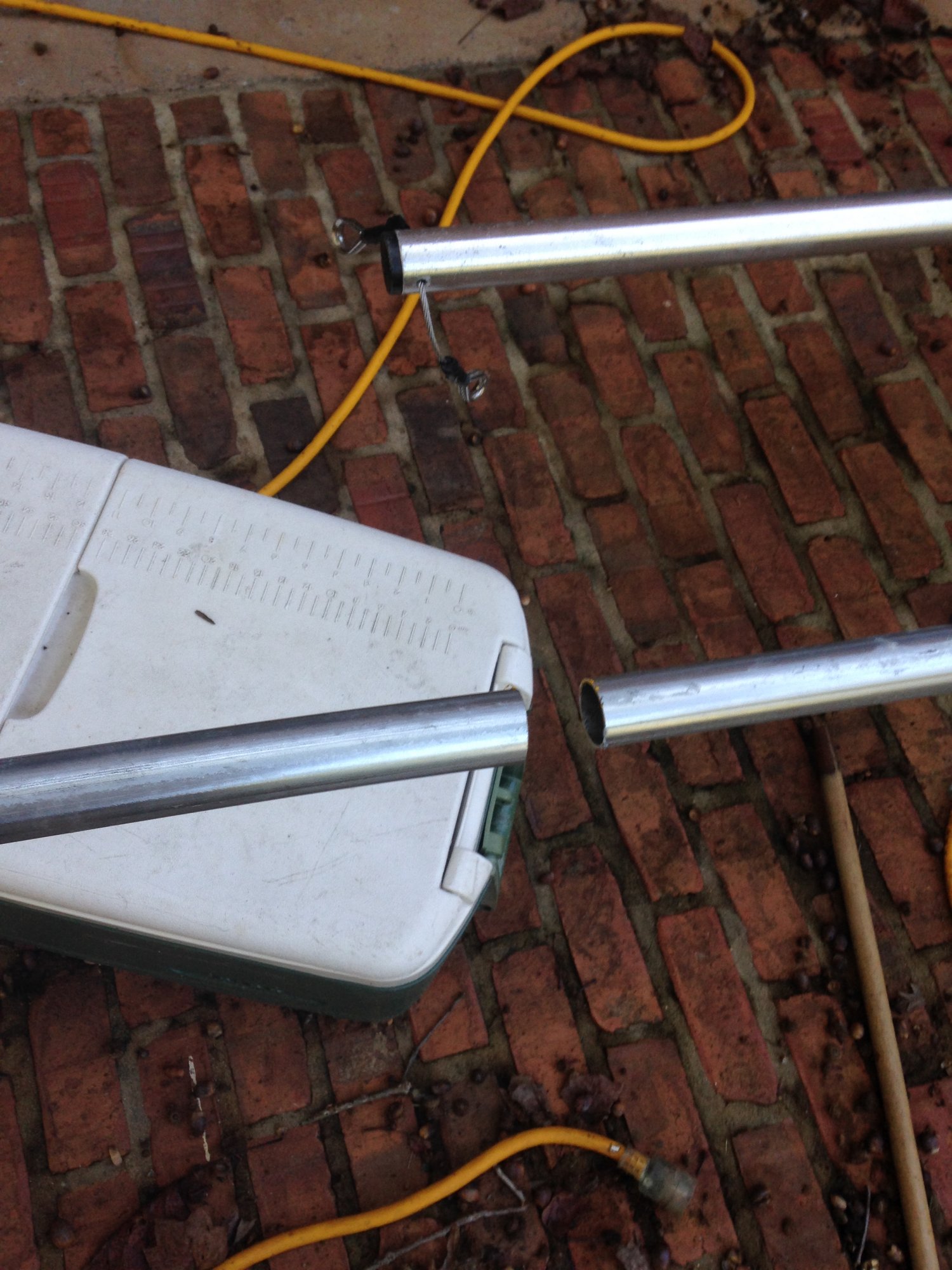

Is the strut the same thing as a gin pole? I'm not sure what part you are trying to replace.
If it is the gin pole used in raising the mast, the tubing is the same as the rail tube on a chain-linked fence. I made one for my H26 from parts I got at Lowes.
