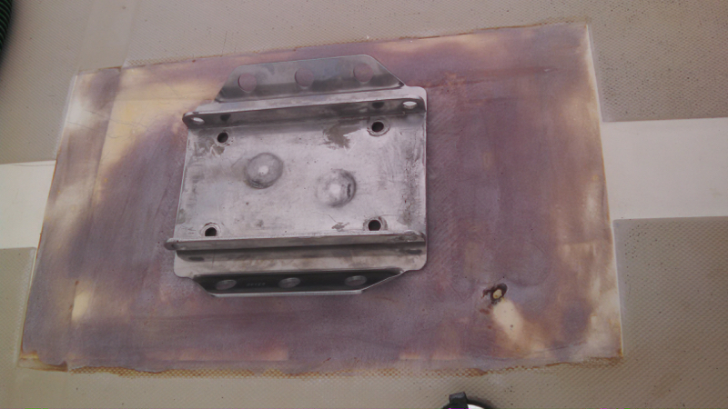

Nov 1, 2012
108
Ok, it's all patched, sanded and painted(picture before painting). I'm ready to install the hardware I know where the holes go from the bottom. One comes through at the bulkhead. Do I just drill straight and pray--usually the way I do things btw. image-202260799.jpg
Sep 25, 2008
992
Oday 25 Gibraltar
Ok, it's all patched, sanded and painted(picture before painting). I'm ready to install the hardware I know where the holes go from the bottom. One comes through at the bulkhead. Do I just drill straight and pray--usually the way I do things btw. View attachment 88343
That's pretty much what I did. Maybe try a smaller drill bit so You've got a little room to play with. First one and then check for position. Make sure the tabernacle is facing the right direction. The way it sits looks like the stern would be to the right, I think.
