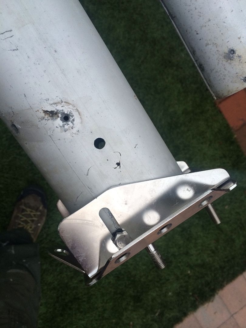

I have the new mast step and halyard plate. the only issue I have, which I just noticed the other night, is that the hinge bolt slots on the mast step are cut in the rear 1/3rd, but the hinge bolt hole in my mast is actually dead center. This will effectively move my mast back about 3/4 inch (roughly). The problem with that is the aft side of the mast will sit on top of the angled vang attachment. I believe this can be solved by cutting the 45 degree corner off the aft face like I see on other mast sections. Otherwise I will have to cut the bottom inch off my mast so I can re-drill the hinge bolt holes to align with the new mast step, and then use the spacer kit.

Now I feel silly... last night it was dark when I test fit my mast step to my mast which is laying on sawhorses in the back yard. I didn't fit right because my bolt hole is drilled dead center... Well, that is certainly correct... for the TOP of the mast where the masthead and shroud tangs bolt on, LOL.
So after work, in the light of day, I could see my folly and actually placed the mast step at the base of the mast where my hinge-bolt hole is in fact drilled at the aft 1/3rd mark... Fits perfectly.
On that note, here is some pics. BTW, I will still probably cut the bottom inch off of my mast and use a space. Looking at the base it is obvious without even using a framing square that the bottom is not cut at 90 degrees... There is some corrosion damage and the holes are little bit messed up and too close to the bottom. I think I will make the cut square and re-drill the holes just maybe 1/8" to 3/16" higher than they are. And just because I can't do anything without over engineering the piss out of it, i won't be using the CD spacer kit.... I have a special plan. (insert diabolical Bond Villain laugh)
