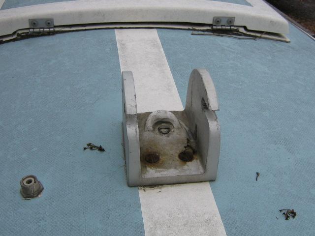

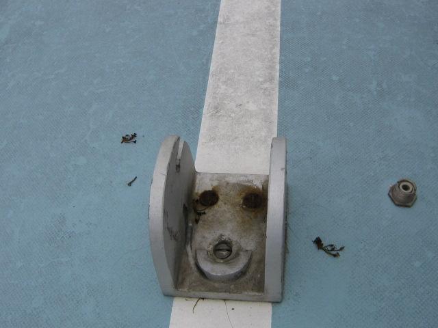

That's what mine looks like. The hump on the mast step prevents the (original) mast from moving aft.

Picture below of original O'DAY 22 mast-step for 1973 models (used until at least 1976). Original color of the anodizing on the spars for 1973-6 O'DAYs was a gold color, hence the "Gold Medal Fleet".
Dear Sunbird,
Many many thanks for the photo. A picture is truly worth a thousand words because you've saved Norma and me great headaches and expense.
Fair winds,
