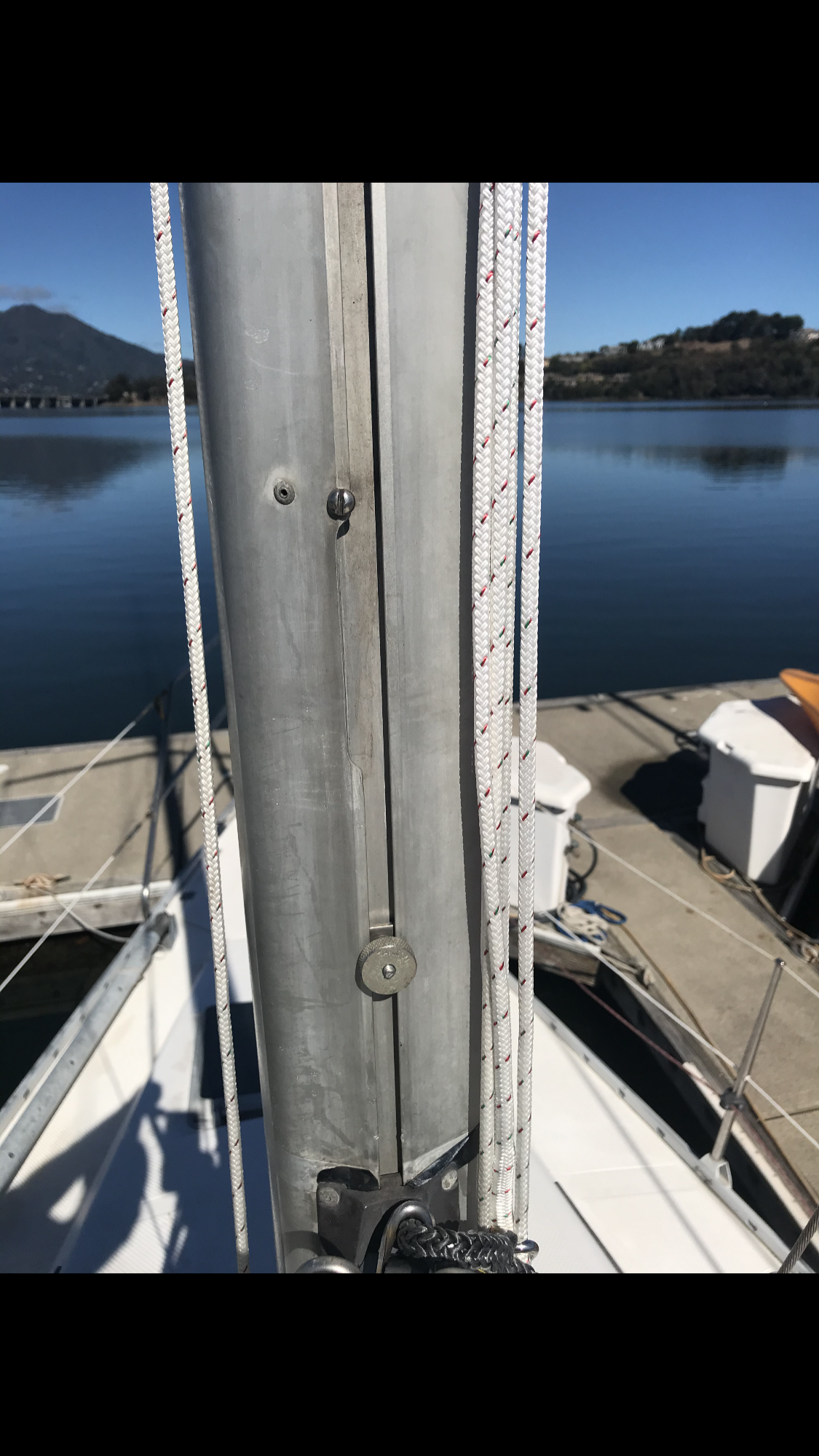

I have a opening in my mast track for feeding in the sail slides(see pic).
The sail slides on the lower part of my sail go below the opening when all the way down.
The rest of the sail slides go above the chanel.
My issue is when I need to raise or reef down the sail I have to remove the sail track stops then move the slides up or down past the opening then re insert the sail track stops.
Singlehanded its a pain in the arse, any ideas about any parts to make the chanel opening so the slides won’t come out, then I could reef/adjust the sails from the cockpit?

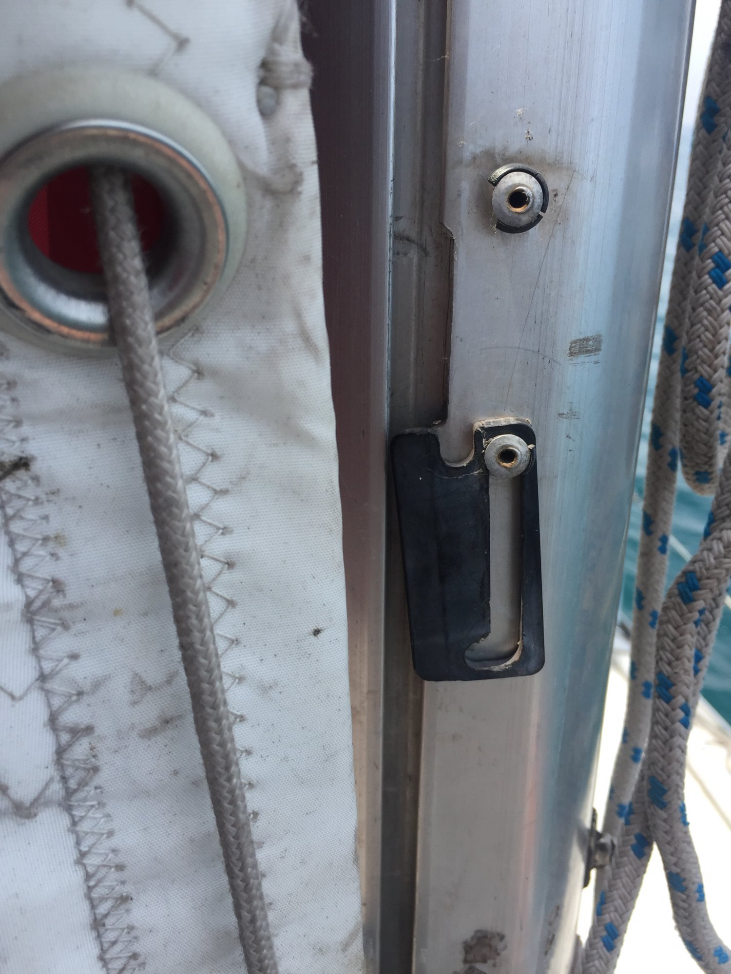

I recommend them, I put them on my Cat 27. They will need some trimming to fit YOUR mast exactly ( in my case a fair amount of trimming). Once set up, they are great!!

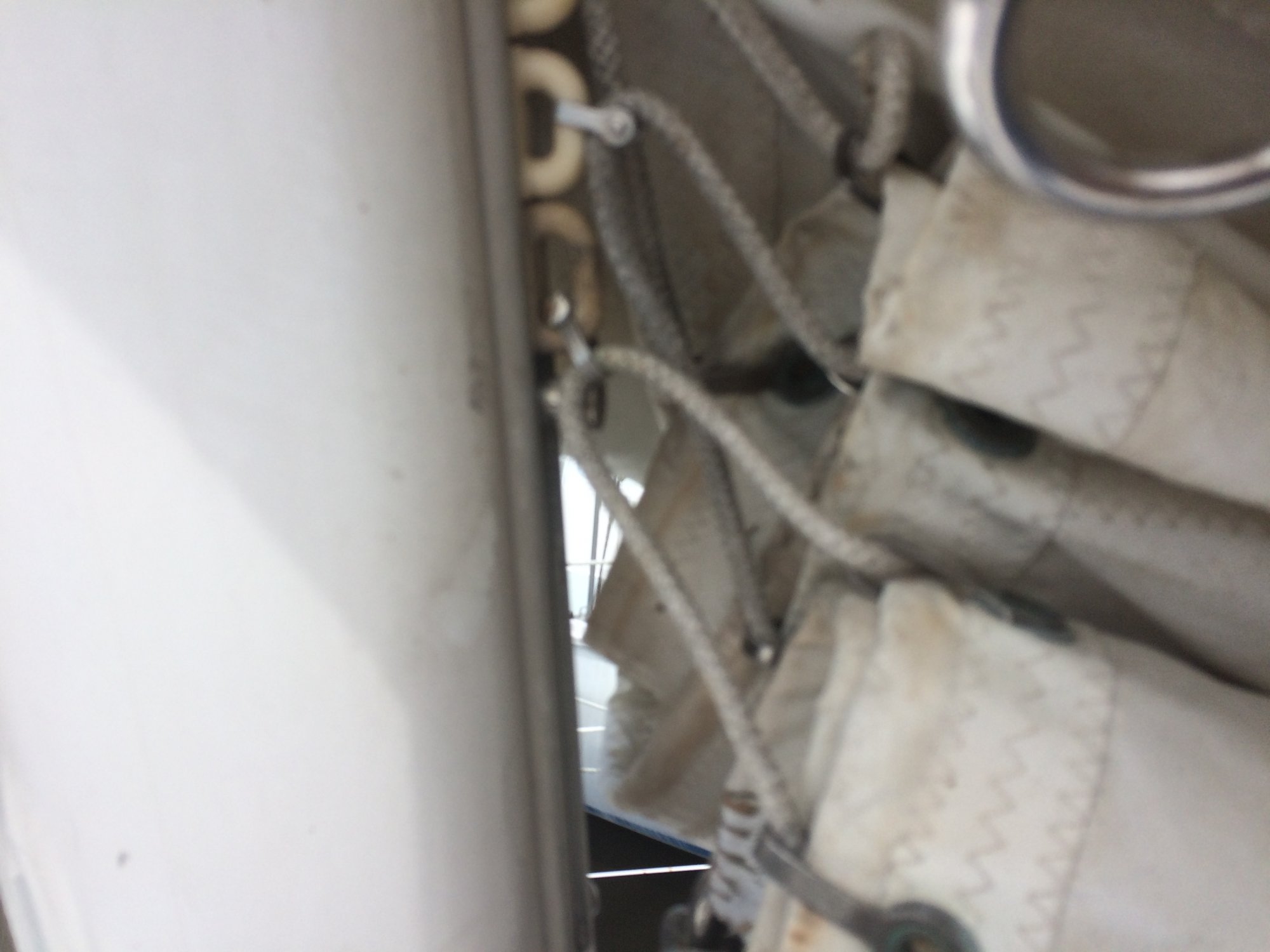

10,134

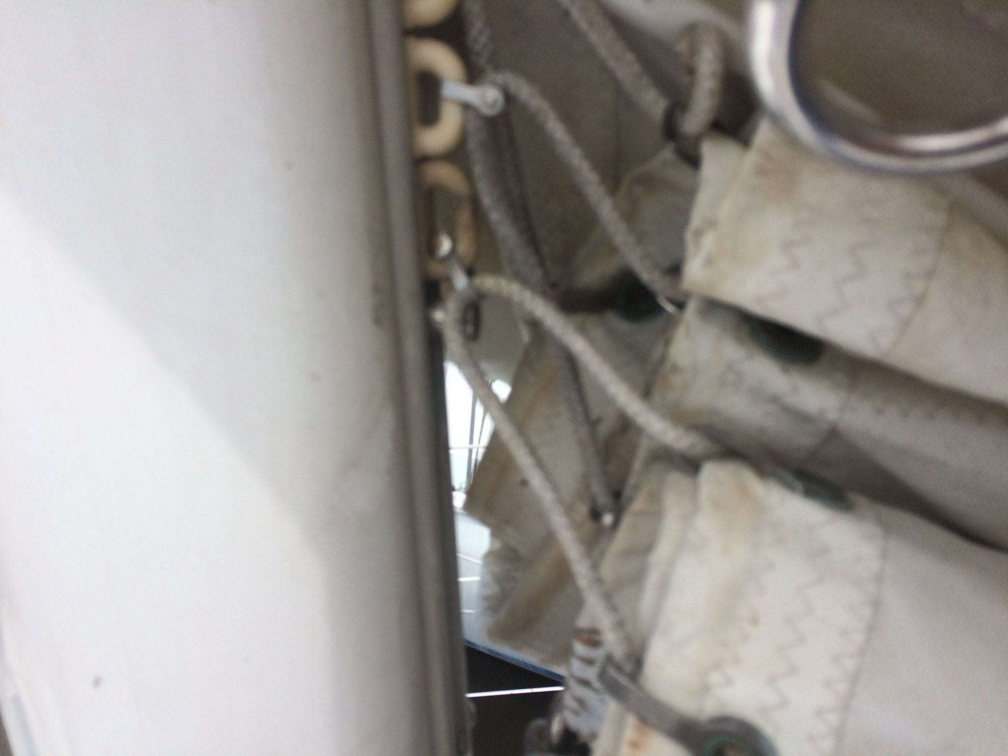

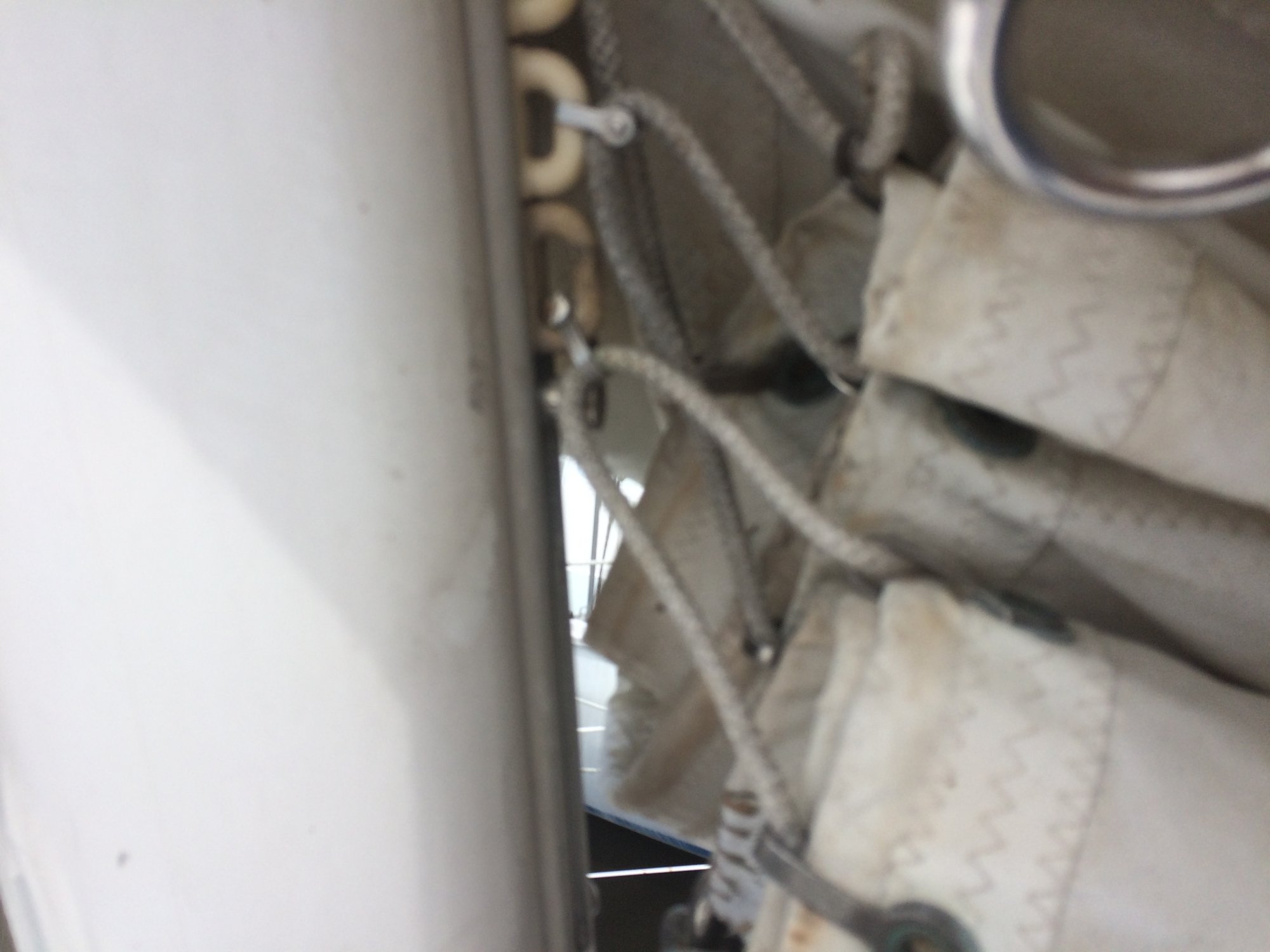

The original mainsail bottom slides were attached with a kind of boltrope thing where all the slides stayed above the gate but the sail came down against the boom as the rope slacked when reefing.. There is a name for this kind of thing, but it escapes me . Dr. Judy may have an answer too.. Picture is what it looked like:
Likes: ScottySailor

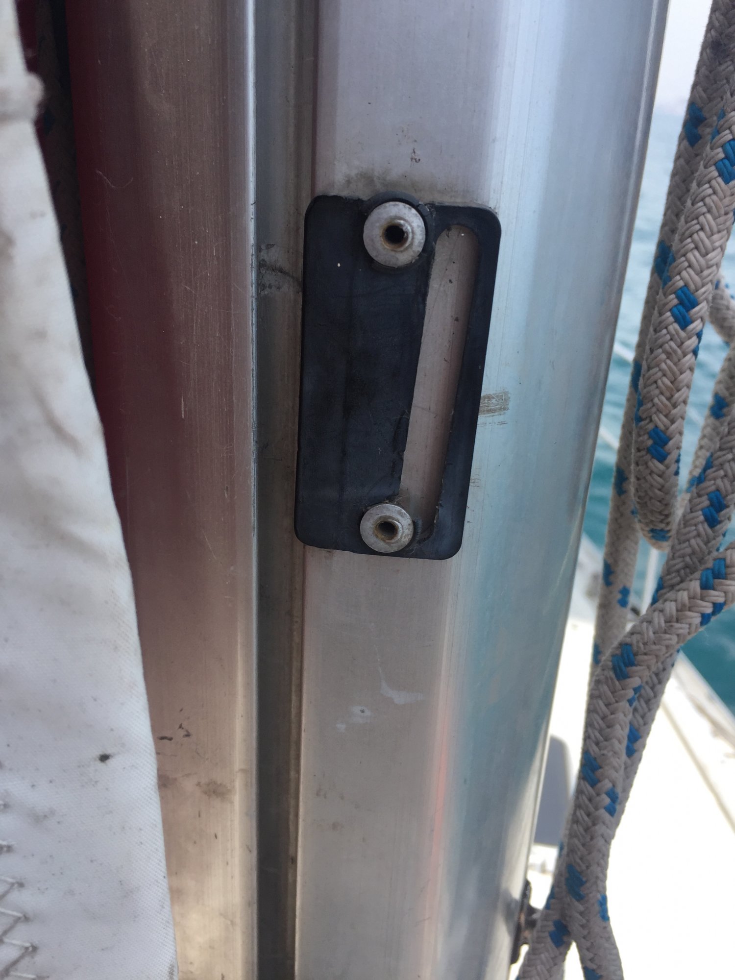

Jan 7, 2011
5,794
Oday 322 East Chicago, IN

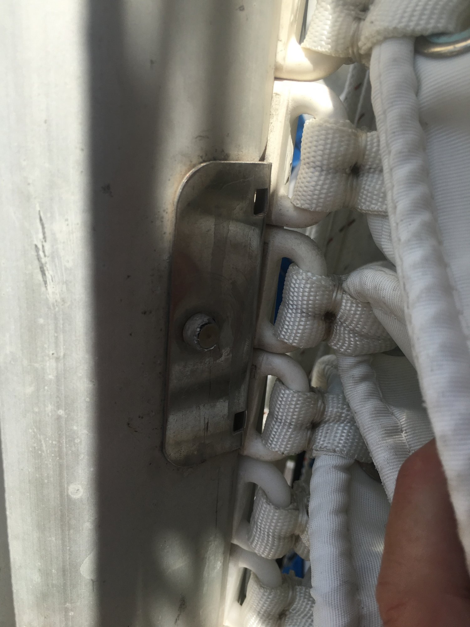

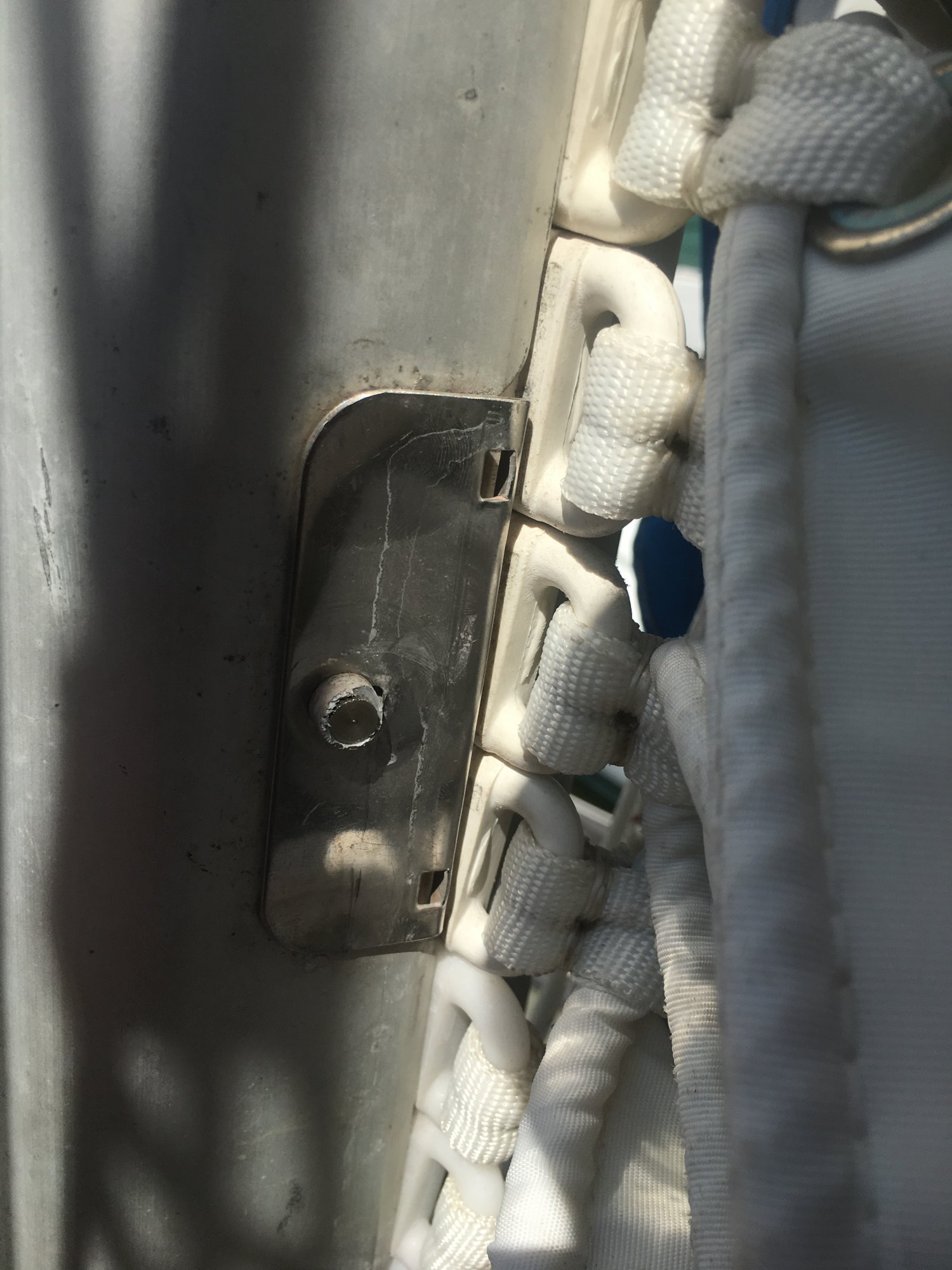

Yes, the mast gate is what you want. Here are a few photos of mine, open and closed...
mine was made of plastic.
8560A8FE-9325-411D-BE74-85828E4DDF55.jpeg 12CB27B5-9436-4CC7-8290-46BDFDCA6B3C.jpeg
My sail also had the jack lines that @kloudie1 posted the pix of...but I didn’t really need then since my slides could go all the way down.
I have since upgraded to a Tides Strong Track which loads the slides in from the bottom...so no need for a stop or a gate (other than the one that is part of the track). Also upgraded the sail so no more jack lines.
Greg
