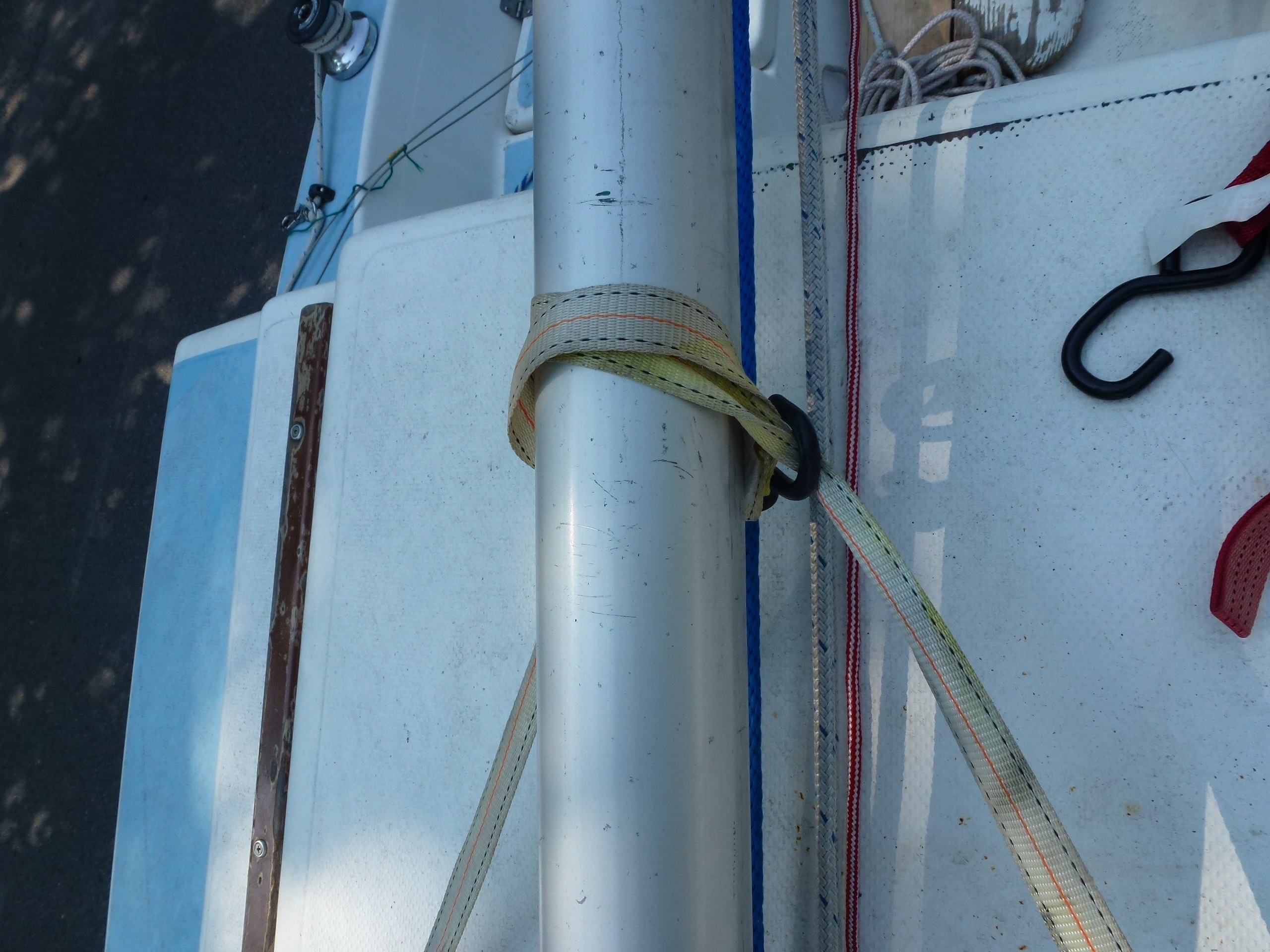

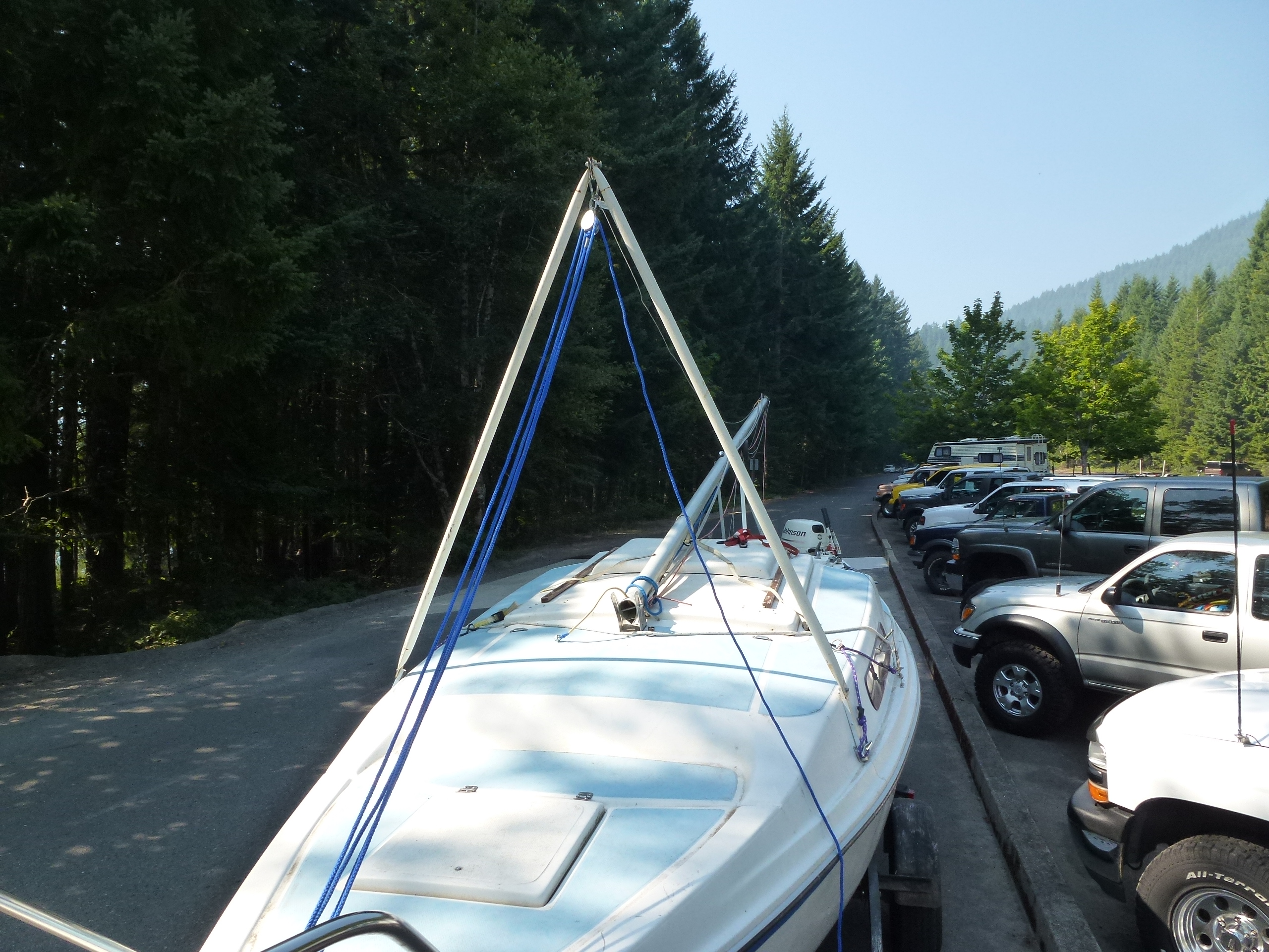

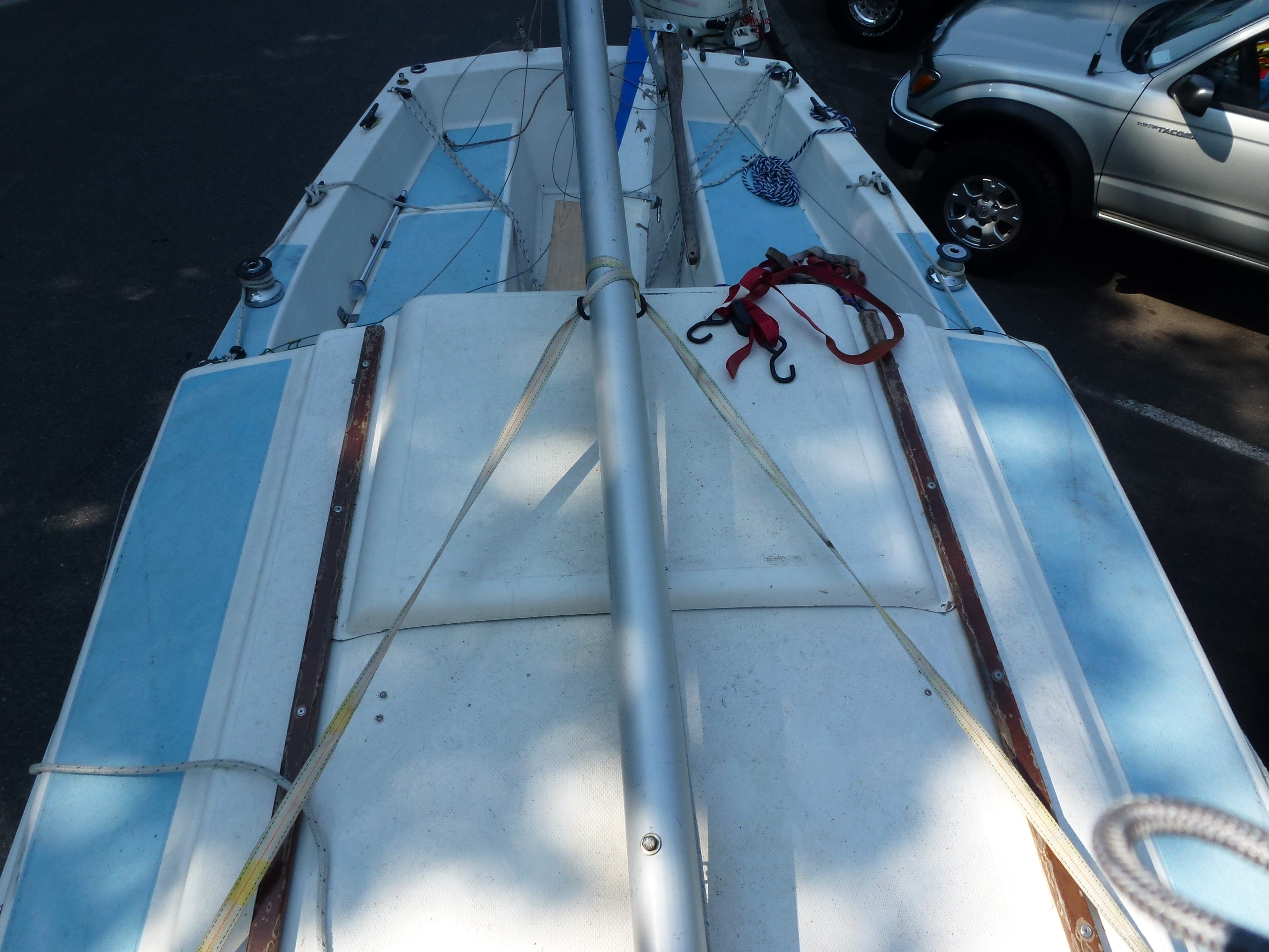

I first started with a single mast raising pole but switched to an A frame when I found both single pole and mast needed baby stays. The Mac shrouds are aft of the tabernacle so they don't work until the mast is fully raised. I've also only used cargo straps for baby stays in thinking that fewer corrosion points added to the boat is better. The straps stay in place when kept in tension the same as a timber hitch will. After raising the mast it is the same as when I got the boat except older like me.
