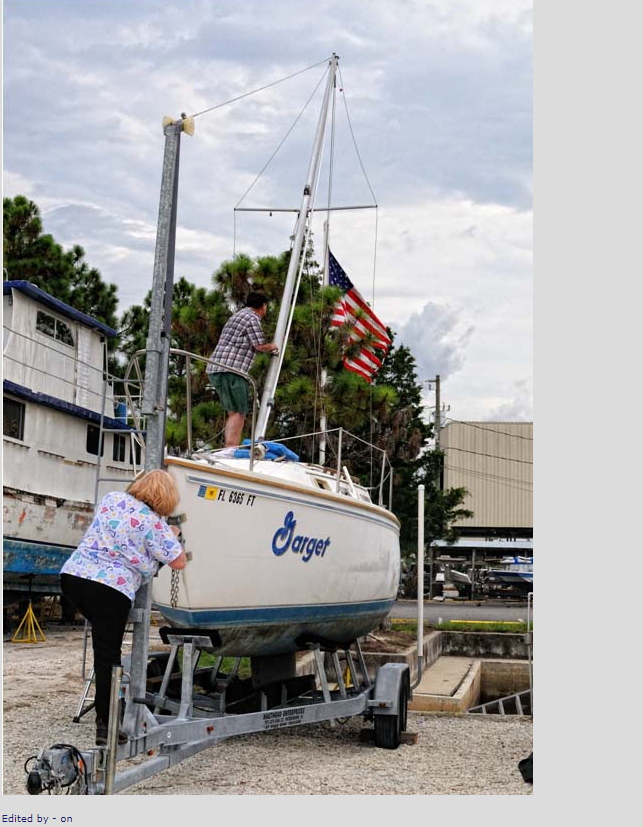

I never had to adjust my side stays on my last boat that had swept back spreaders. I have to loosen and readjust on my O'Day 25 that has perpendicular spreaders. I use essentially the same setup thats in the pic that was posted. Is your boat in a slip, mooring or trailer? Are there any bridges you need to pass under?

My current boat has a mast stepping system built into the trailer. A long steel beam slips into the bow support. I have an electric atv winch mounted towards the bottom and a block for the winch cable at the top. The cable is tied off to a halyard. I use a mast crutch to prevent the gooseneck from touching the cabin top.
My mast crutch is simply a couple of 2x3's screwed together to form an X. It gets tied to the rear pulpit and cleats. If I didnt have this I would be assisting holding the mast as far up as I could in the beginning. That's a lot of stress on the mast step. The higher the pull angle the less stress.
The ATV winch is a 2500lbs wireless one I picked up from harbor freight. This is light work for it. The wireless feature is fantastic and I've de-stepped using a little 7 amp gel cell battery. I think a 7 pin trailer connector could easily power it as well
My system is essentially the same concept as this
