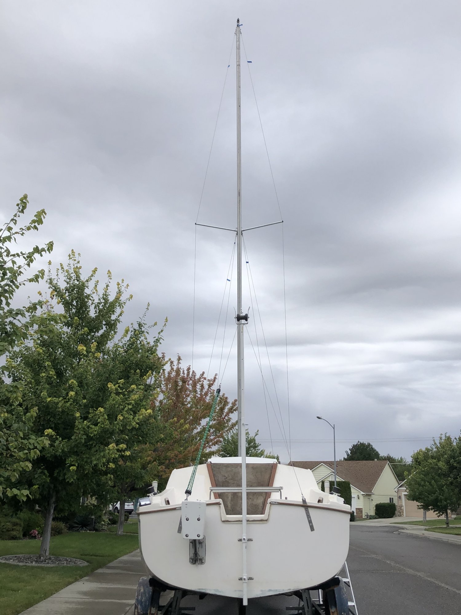

The best video of the process belongs to Stingy Sailor;
I use his basic principle ( I don't use the gin pole option) and use the mainsheet tackle (4:1 purchase) attached to the stem fitting and the forestay. As @AaronD mentions, the key to the single handed raise is the fact that my lower aft and main stays remain ATTACHED. Only the forward lowers need to be disconnected to effect the lift. Added a pic below that shows my use of the mast extension purchased externally.
Once you have a modicum of lift underway-- the side tension of the stays keeps the mast completely in column-- I have attempted (poorly) to video with one hand while I raised and lowered-- showing that you can stop mid lift safely walk away, tidy something-- and continue with no risk.
At the end of the day-- get some help while you formalize your routine, but it can be done one handed with tooling you already own.

Below is a pic just before I attempt the lift : notice the slack in the stays-- a foot or so will put them in tension and solve for any lateral movement:
Extension for reference:
Only if you have a masthead rig with straight spreaders. If you have a fractional rig with swept spreaders, the side shrouds don't do anything until the mast is completely up.
