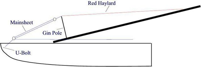

Hi,
I have a 1993 Hunter H 19-2 and am missing the mast raising "gin" pole, I have the shorter shrouds for it but I never got the pole itself when I bought the boat. I have been looking for quite some time to find one but have not had any luck, so I figured I could make one up if I knew the dimensions: Pole length, tube diameter & thickness, along with a drawing of the fittings on the top.
An instruction sheet would also be quite helpful too!
Thanks.
I attached a photo of what I am looking for.

I don't have a 19 so can't help with specific dimensions. However, what you want is a pole that when the mast is vertical will extend forward to near but not quite as far as the forestay. You will be using some sort of block and tackle to pull the pole (attached to mast via halyard) down until the mast is vertical. Then while held in that position you attach the forestay to its chainplate, in front of the fore end of the gin pole and the line from the mast down to the gin pole upper eye or other such fitting.

As Crazy Dave states, you can get the pole diameter from the hole at the base of the mast. The original gin pole had a cut out on the very end to fit the wire chase on the inside of the mast.
To get the length, measure from the mast step to the u-bolt. With the mast fully up, the end of the pole is directly above the u-bolt. On the H260 that's about 12 feet.

First go back and review the owners manual on line under boat information for the 19 (1993-1996). If it does not show the specific length, the best was to measure is from the back of the mast to a point vertical attachment of the mainsheet from the boweye in the anchor locker and add about 3 inches. The back of the pole needs to be curved to fit over the sail slide channel. At the other end you want to drill a hole for a wire to go thru with two looped ends secured twice on each side. It will depend on the size hole of the mast that the diameter of the gin pole should be which is probably the larger aluminum pole of that period used by Hunter. Why don't you contact Eddie at Hunter to see if they still have the exact measurements.
