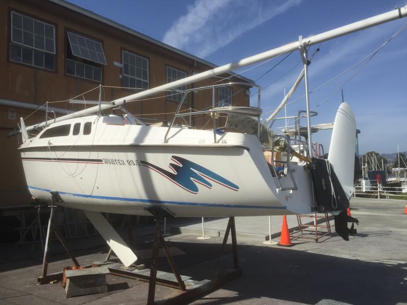

My first mast raising on my new to me 23.5. I had done it a few times with the sellers, with their help. But this time it was solo except a friend helping me. All was going well until we began the actual raising. I mistakenly let my friend man the block and tackle, while I managed the furler. He is a strong guy, and I noticed he was straining the first few feet. Then I saw him really pull hard with his entire body weight. The surge pulled the mast over to the right and badly bent the mast raising pole. Post mortem, it looks like a shroud was on the wrong side of the mast crutch and pulled the mast over.
I think the mast is ok, put need a new mast raising pole. Can someone point me in the right direction? I didn't see one on the hunter.com site, but I am probably not using the correct name for the pole.

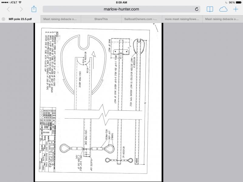

On one end is a double looped wire with thimbles. if you do not have the materials take it to a yard to do that for you. Measure the one you have and duplicate the length.
the other end will have to be curved so when it inserts, it will rest properly on the inside of the mast due to the sail track that runs on the backside of the mast. It is pretty simple to make but again only use the same diameter tubing.

As Dave points out, there is an excellent schematic in the manual. I guess I'll print it out and take the pole to a welding shop to see what can be done. Anyone on the forum know of such a shop in the San Francisco Bay Area? LA?

Anyone know if the gin pole from a 240 is the same as a 23.5? The 23.5 is 6'4" long according to the manual's schematic.
