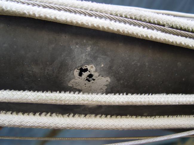

Hi, I'm looking at a 40 yr old Cal 25 that has the old mast type so I'm placing an age of about 40yrs on it, It was also a thin one. It seems to have some pitting I guess. I'm not certain from what, possibly oxidation I guess. I'm not sure how concerned I should be about this. Here is a pic. t seems to be a section of about 10' and probably 8 of these holes. If you have any input it would be great. Thanks for having me, Ian

You could get it welded but I would not trust it to hold up my clothes lines. Who knows how many more of those are getting ready to perforate from the inside. A hole like that and being 40 years old. This is a prime example of something to negotiate with. I am sure your surveyor says the same thing. If not, find a good surveyor. This could also be an indicator of overall condition of the boat. I would walk if either the price did not reflect a reduction for a replacement or adjusted down to cover it. Tim R.

Tim is right. This may be an indication of the overall condition of the boat. The mast cannot be repaired. If you had to ask this question, i will assume that you are new to sailing/boating. Buy a boat in sailing/motoring condition and sail it the day you own it. In the $4 to $6K price range you should be able to find a similar boat in fairly decent shape with a good motor. Keep on looking. IMHO Tony B

the location of that big hole does not seem to be a problem to me... down low... plenty of good metal around it... sitting in a shoe. Not like there is any stress there... just the weight of the mast and rigging? Im I missing something? Rich

I thought that it looks like it has been kept outside
under a pile of other junk. Those random spots may have been the result of other metal in contact with the mast. I suppose that the grommets in a tarp could be enough. I thought that I saw some bondo in the picture. As though someone had attempt to patch the spots.

That may explain why it seems limited to a small part of the mast. An indifferent metal reaction galvanic, electrochemical. Maybe

Contact Rig-rite. They are in RI. Ask them for a new mast. They may have the exact piece to replace what you are looking at. This will give you an idea what you should subtract from the asking price. I would bet that the mast would be more that they are asking for the boat. Your other alternative would be to contact a salvage yard and see if they have a unit that could replace the existing one. My thought is that you should look at a vessel without ANY structural problems if you are on a budget.

I would not even think about putting that mast up. You have no way of knowing what other places are weak, or how weak the areas around the holes are. I would suggest that you take a browse through ebay. Every once in a while, there are some rigging parts, including masts on there. Too bad your not on the gulf coast of La. Miss. or Ala. You could probably find one laying around for nearly free.

Just a little more on this thread. Last night after reading this I
took a piece of aluminum foil and placed it in a glass dish and put a small piece of copper tubing , two steel nails, a brass nut and a piece of solder on it and added a little salted water. 24 hours later the foil is as full of holes as a lace curtain. That corrosion doesn't take long to distroy aluminum.
