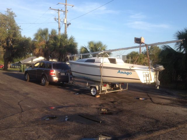

I've only had trouble launching my 18.5 once and that was at a very shallow ramp. Even with the tongue extension out, I barely got it off the trailer. Retrieving has gone fairly well. My biggest issue with that is getting the boat far enough forward on the trailer. The winch post, since the trailer is on a downward angle, gets in the way of the bow since the boat is floating level. My trailer has no guides unless you are referring to the poles that extend upward above the topsides. I'll look for the link you mentioned.
Thanks for taking the time and sharing your experience!
10,499
-na -NA Anywhere USA
The bow first is hitting a black roller which is making it harder to pull up and over. Consider shortening or try removing. The bow might come to the V chock on the winch stand or not but don’t sweat! With mast down and tied, pull up onto level parking or level ramp and stop hard. The boast will move forward and then winch in loose winch strap. Do this repeatedly until the boat is firmly against the winch. Time to talk. Private message to you being sent
