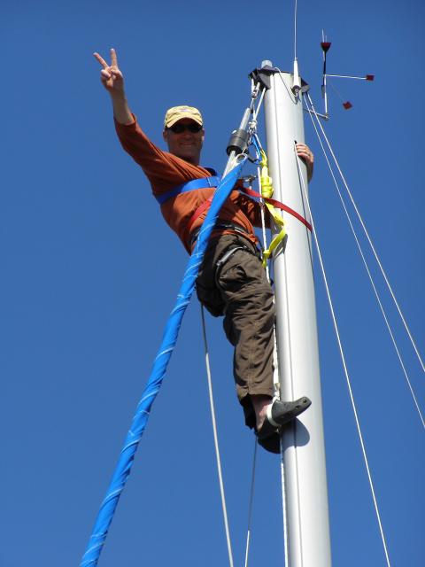

I went with the ascenders/climbing harness route as well and finally had a chance this past weekend to use them. I also wore my body harness with a strap around the mast so I could lay back on the harness for leverage while drilling holes for some new hardware up high. It worked great. I'll tweak my system as needed but the beauty of it is that you have the ability to stand up and be at least eye level if not higher than eye level to the top of the mast.

The ascenders are attached to the halyard one above the other,or climbing rope which is cleated off so it is a static line. The top ascender is attached to your harness via webbing and two caribeners. The lower ascender is attached to the webbing footloops with two caribeners. Put your feet into the loopswhile standing on the deck, with everything attached, slide the upper ascender up as far as you can (this is where you'll have to play with the length of the webbing to get it right) then sit and pull your legs up while you slide the lower ascender up. Stand up on the footloops and slide the upper ascender up, repeat and inchworm your way up. It takes a little getting used to the routine and going up is quite a bit easier than coming down. As I said before, I used a body harness with a strap around the mast to keep me close to the mast. I also has a backup halyard and a friend belaying me on deck. You can't have too many redundancies here.
