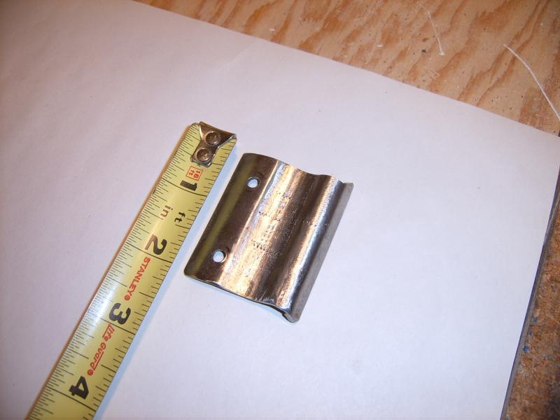

I made one out of 1/8 ss. Here is a picture- the advantage is that with a gate, you can bring the slugs right down to the gooseneck which makes it possible to reach the reefing hooks with the reefing cringle.
Jun 21, 2007
2,118
I made one similar to Richard Bryer's finely crafter lug stopper. But instead out of 1/8" aluminum plate which I had scavanged from some other not needed part. The aluminum was easier to work with and has been plenty strong enough. To DIY you will need to drill and tap machine screw threads in the mast to match the holes you make in the stopper plate. I opted for standard 1/4". Since the screws are stainless steel and the mast is aluminum, galvanic corrosion will occur between the two metals. So be sure to coat the threads with lanacote or anti-seize grease. Depending on the curve shape of your mast, you probably will have to bend the plate a bit so that when the screws are tightened, the plate firmly covers the slug removal opening.
