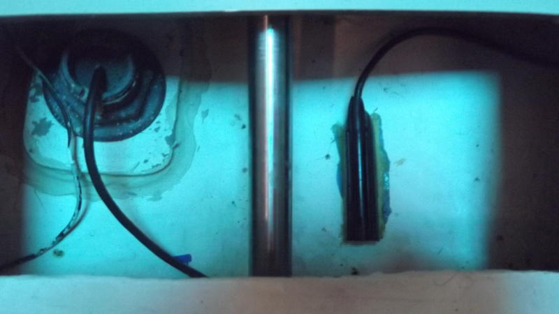

depth meter - easy fix.....fishfinder
If they haven't cut the hole yet I'd buy a GPS with depth/fish finder. I use a Lowrance elite 5 DSI ( I think that is the model). it can shoot through the hull and give you an excellent profile of the bottom. The imaging is not picture image ,it degrades a bit through the hull but is clear bottom profile. prior to mounting, place the tranponder in a plastic bag full of water to see the image. Once satisfied with the image / location epoxy it to the hull. Mine it mounted in the small access cover next to the head. Make a small dam around the transponder and fill with the 2 part epoxy.... works great. I'll be on the boat later this week and post some pics.

Epoxy is a tough way to do an in hull! Toilet bowl wax, plumbers putty works well and I use silicone. With epoxy you better hope you don't EVER need to remove it! Chief

PLEASE, NO Epoxy! Take a look at our web page (http://www.svguenevere.com/prep/proj/depth/ ) to see how ours shoots through our hull.

Thats beautifully done Greg! If only these people who keep asking would look at that web page! Chief

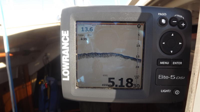

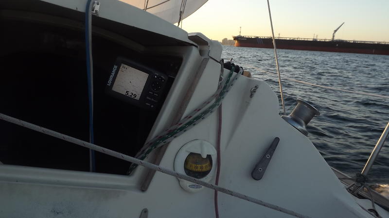

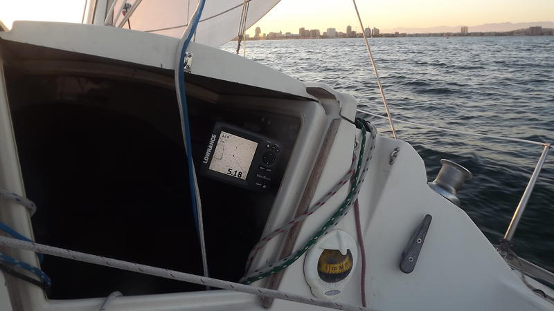

Attached are some images produced by my Lowrance GPS chartplotter / fish finder. I guess you would consider it using Sonar to detect bottom depth. Not only does it allow you to see the bottom it allows you to display knots, voltage etc.,etc. base on GPS. If you have a compatible VHF radio it can send your co-ordinates automatically if you are in distress.
This technology use to only be within the reach of megayacht owners - now it within reach of us little guys. Learning to trust what your seeing is easy. Just find a sandy beach and test it!
I prefer the Garmin software of my old 176c but my old eyes needed the improved screen resolution of the newer models. When it came time to upgrade the Lowrance unit was a no brainer cost wise at the time.

As for the use of epoxy, that is an installation instruction with emphasis on NO air bubbles as the transducer needs 100% contact to work properly. That is where the trick of using the water filled plastic bag mentioned earlier in the thread. I was a skeptic too.
Regarding removal - I have a grinder. Easier to remove the transponder than filling in those big holes where the Signet displays are mounted.
