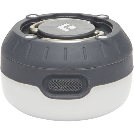

Friends gave me one of these, and it would be terrific in your situation. If you hang it above the cockpit, it would double as anchor light and cockpit light. And no electrical draw from your house bank. It’s a surprisingly bright, even all-around light. LuminAid solar lantern
(p.s. Yes it doesn’t have a CG certification to meet regulations, but nobody enforces those. The only way I foresee it becoming an issue is if there’s a collision and then lawyers get involved in the aftermath.)
