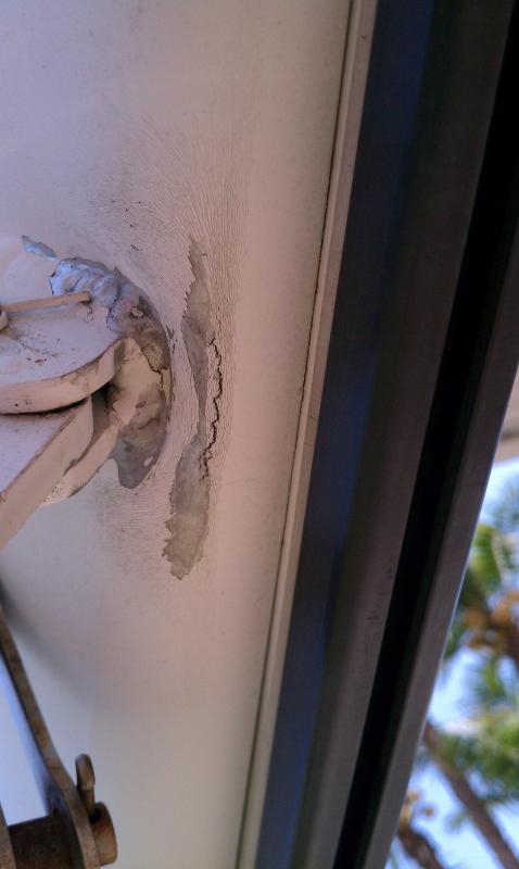

Had to take the mast down due to a crack that has developed on the mast just aft of the lower starboard spreader. (See Pic) While it's down I want to repaint the mast. Any thoughts on prep? Do I need to take it down to bare metal? Also replacing everything on top of the mast and rewiring.
As far as the crack goes. I'm having a U shape collar manufactured. We will remove the spreaders, Weld the collar on and then re-weld the spreaders back on.
