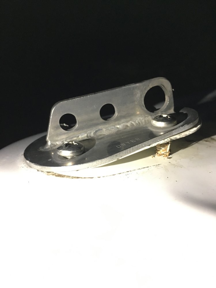

After our sail, I looked at the stemhead fitting and saw that it was pulling out of the bow. YIKES!
(SEE PHOTO). So... I need a repair on the fitting (I'll hire that out), advice on sailing with bent mast; and/or how to bend straight if feasible; and how to figure out what the heck is happening with my rigging! Thanks!!!

Regarding the stemhead... try a stronger installation, i,e, through bolted with backing plate or washers.

Take the stemhead fitting completely off. Make a proper backing plate; you should be able to find the material and tools at the big box home center. Rebed the fitting in accordance with the instructions found here: https://marinehowto.com/bed-it-tape/

The picture of the bow fitting gives me the willies. SCREWED to the deck, what where they thinking?
They might have been thinking that pulling the fitting off the deck is preferable to pulling the deck off the hull.

The forestay chain play was screwed into he a wood plate encapsulated in the deck and concur this was not the best way of doing that. Pointed that out to the powers to be at Hunter. You will have to put an inspection port in the deck to repair that. Send me a private message with location and phone and will be glad to advise. I introduced the boat and sold my fair share of them

I recently did some transom repairs on an ACP hull that had a couple of screws pull out. I drilled some oversized holes where the screws were, hit the holes with a blow drier for a long time to get the wood inside good & dry, then stuffed the holes full of epoxy soaked fiberglass cloth that was rolled up tight. After the epoxy hardened, I then cut off the excess glass that was sticking out of the holes & filed the stubs flush with the original hull. The results were good. The new glass took a screw real well. I think that the screw will probably break before it pulls out again. My glass plugs were 5/8" in diameter & a few inches long. In hind sight, I would probably only go an inch or an inch & a half deep with the glass if I were going to do it again. A similar repair may work well on your bow.

The biggest problem with stuffing rolled fiberglass into the holes there are two things.
First the wood could have deteriorated and secondly the above has been tried with the screws pulling out again and with the forestay chain plate, I would suggest a better
Repair which will necessitate going underneath requireing an inspection port
