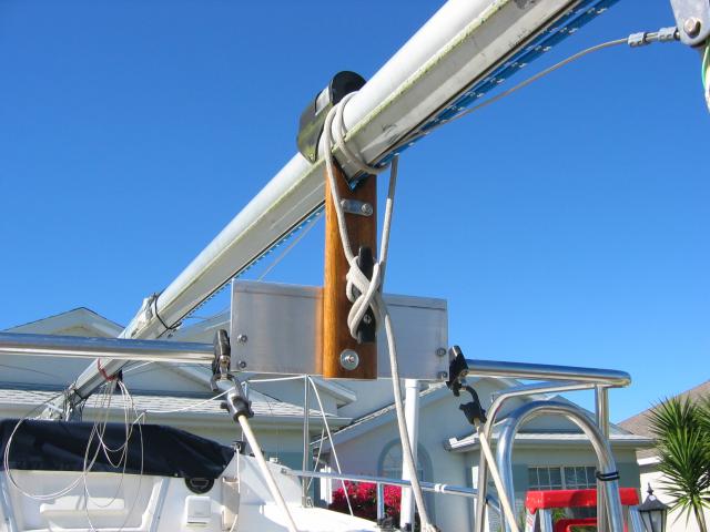

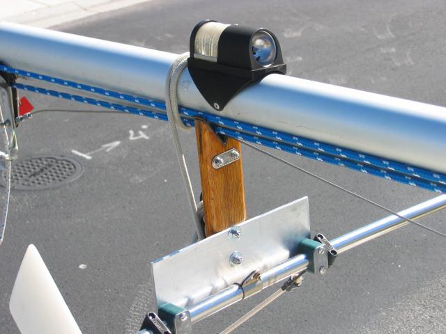

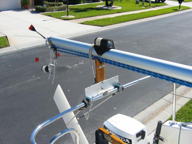

Here's what we use, but it takes a stern rail. Not sure if yours has it, but I thought I'd put in my two cents. We swivel it down when we are sailing. I also support the middle of the mast while trailering if it's a long distance. We got a block of styrofoam from a trailer sales place that they used to block between stacked trailers for delivery. I wrapped it with the shrink wrap you can buy in rolls (to keep it from shedding bits of styrofoam all over) and it works very well.
Good luck!
JDK
