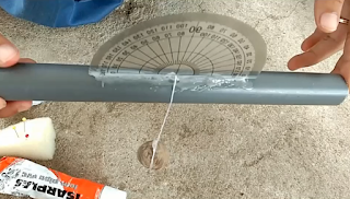

If you are nerdy, you could build a simple klinometer like this out of a PVC pipe and a simple protractor. You look through the pipe at the top of your mast, place your finger on the string to hold the position, then look at the protractor for your angle.

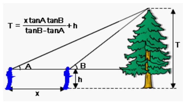

and then use this equation and process
If you are standing on a dock, then "h" would be the height of your eye above the dock plus the height of the dock above the water. You can probably find the mast length on this forum but if you have antenae etc. on top of your mast and/or your water line is a little different than the average... this process will allow you to find the exact mast height. Add 6" for a buffer and you can feel safe crossing under a bridge.
