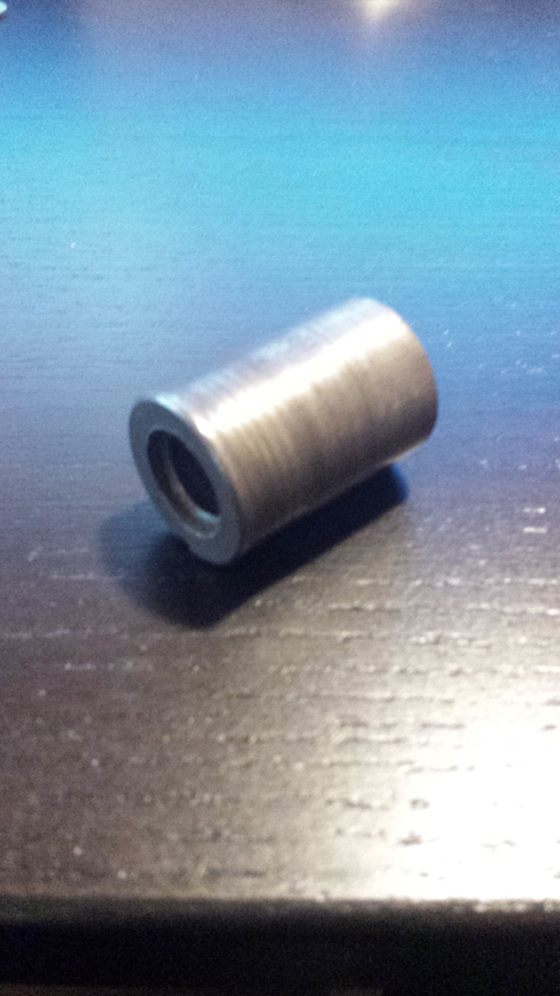

Does anyone happen to know what the I.D. & O.D. & length of the BUSHING that fits in the Goose Neck fastened to the mast. It was lost when the boom and mast where take off at haul out. The picture attached is what it looks like.

Bushing Measurements
14mm I.D (9/16")
22.5mm O.D (7/8")
17.5mm Length (11/16")
Mast Goose Neck will except a bushing of the size mentioned above.
