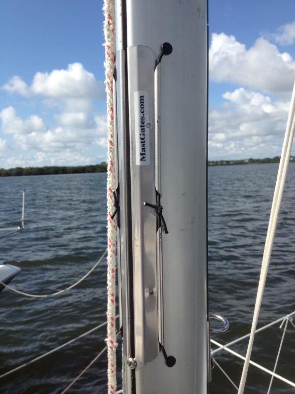

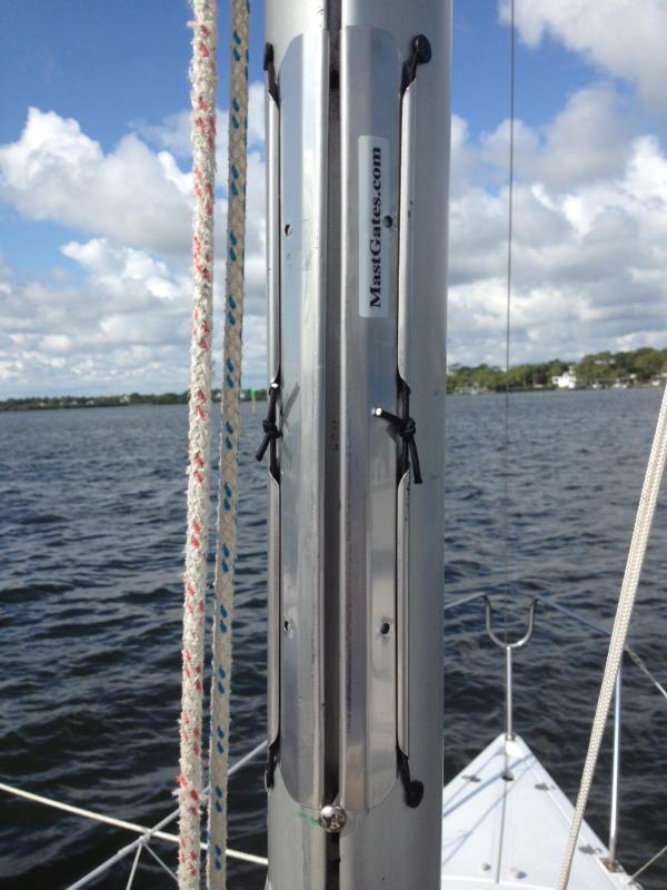

Francespar mastgate
www.mastgates.com.
owner is Tom and is awesome to work with. he made a custom gate for my 1987 23' and it works like a champ.

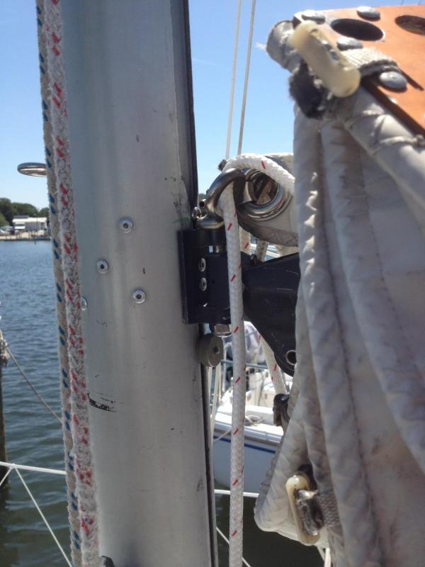

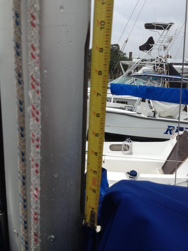

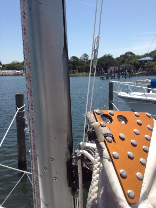

Wally,
I looked back for aold corresponence emails with Tom at masgtaes, but could nor find them. Was hoiping to find all the info I sent.
Hopefuly the attached pics will jog his or someone's memory on our site.
Thanks!
Dave W.
Dave, Thanks for the pictures. Tom asked me for pictures and a profile. I went to the boat today and got pictures. I will include one of yours hoping it will jog his memory.
Wally
