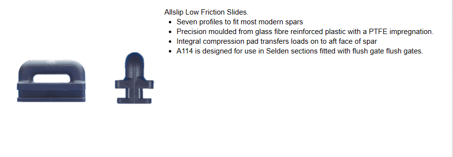

I have the same problem with my new mainsail but those shown at MetaMast would be worse than what I already have. Mine a pretty slim and work great for the typical white nylon slugs but at the bull batten pockets, I opted for AllSlip slides which have an outside support slide face and the gap between is too small to fit over the gate. I need something that doesn't extend outward past the mast. I remember seeing some plastic gates that fit inside the mast and are flush on the outside but cannot find them now that I need them.
