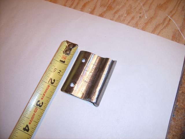

The mast gate on my boat is giving me grief. I have an adjustable bracket on the stbd side of the track. The slugs either hang up or pop out while I'm raising the main. I can't even imagine trying to run the halyard back to the cockpit. If you have a picture of a mast gate that works, would you be kind enough to post it? Any help or advice would be greatly appreciated

I made a mast gate ( I am differentiating here between a "mast gate" and a mast track "stop") I much prefer the mast gate as you can get the main down further to reach the reefing hook and I found the mast gate was always popping out when I pulled hard on the sail to hook it on the reef hook or compact it for flaking. It sounds like you need to take a close look at yours and maybe it has bent a bit, leaving enough track opening for slugs to pop out, Could explain the hanging up also. A bit of carefull work with a small hammer or a vise could be the answer
Here is the picture of the one I made it just fills enough of the slot to keep the slugs from popping out.
