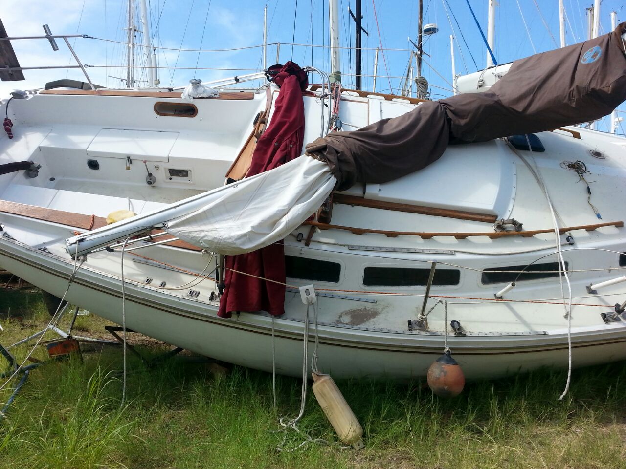

My catalina 30 tall rig was dismasted in Baja California S= during a Hurricane in September 2016 and the mast is dmaged and twisted ; the boat has no damage ; the boat is now in the Marina Real port in San Carlos ( Guaymas ) Mexico . What can I do to repair or replace the mast . Any suggestion will be really appreciated. This is really a first in all my sailing years .My home isin Arizona and my port in San Carlos mexico.

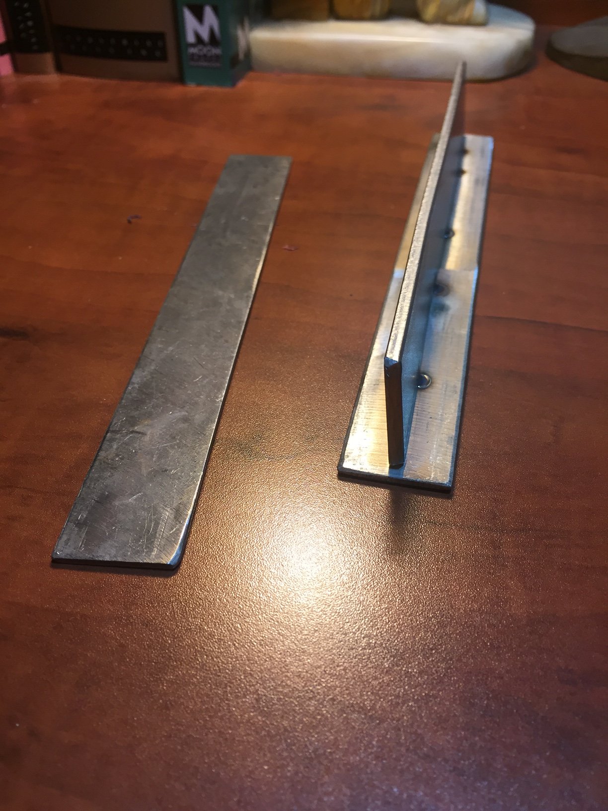

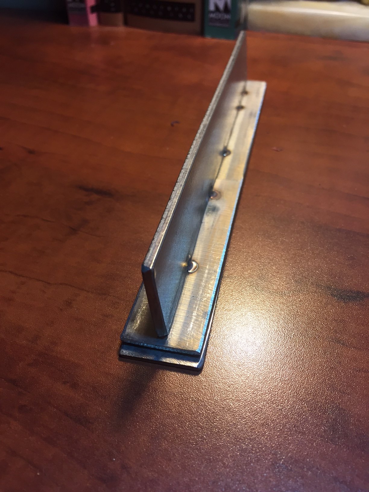

Second, built a T-bar w/ added shim that can be ground down (see attached pic) for adjusting that fit the slug track tight and perfect assuring a smooth hoist;

Slide the t-bar and shim together back and forward as if it were the slide slug, " perfectly smooth transition, Very important!

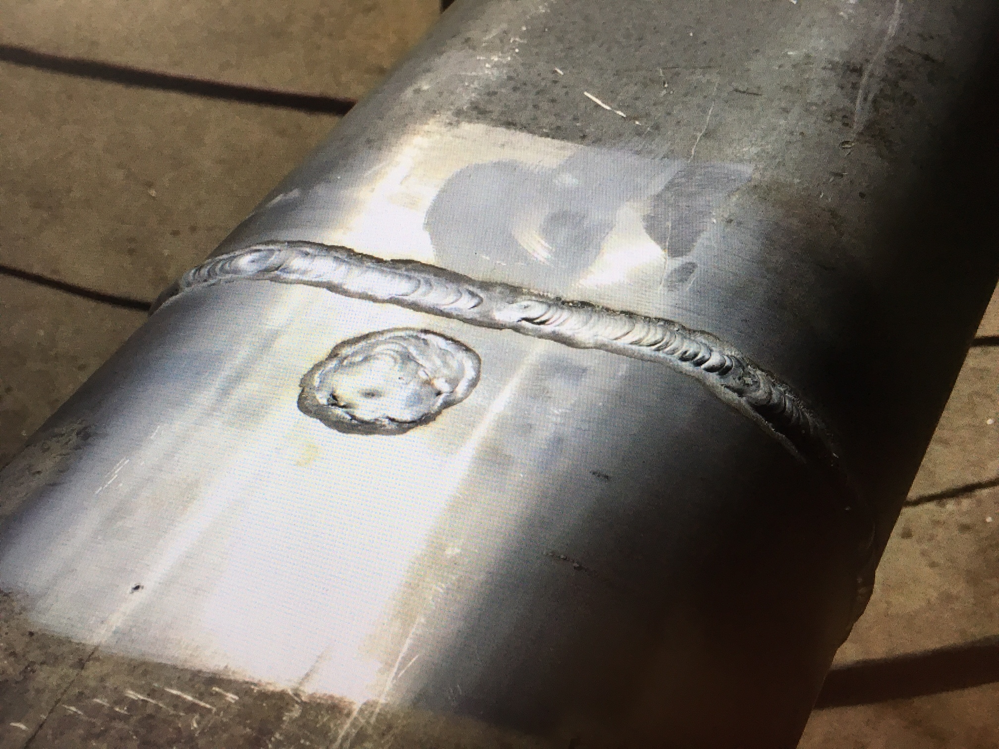

We then drill 2ea 1.25" weld plug holes on each side; use a rose bud to preheat aluminum fish plates, bevel the weld joint 45 degrees out approx 1/4" each side and then made one large pass using 5183 filler rod, we then ground down the welds down just a bit to blend nicely. (see attached pic) A 25 year experienced welder will know what to do here".
