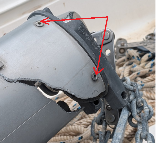

Well I did it trying to raise my H26 mast forgetting about using the stays that must be on the boat somewhere. I am located in Panama. I am going to start looking for someone that could maybe make a sleeve. However maybe someone on this forum knows of some out fit that can make one for me ? I am open to any suggestion for fixing this mast. It was in storage over a year . First because of Covid restrictions and then a struggle getting it sea worthy again here in Panama, replacing this and that and some health issues that required me getting back to a VA hospital in the US. I should have reviewed this procedure for raising and lowering and would have would have used the bloody stays to hold the mast while I raised it. Here in bed thinking about todays disaster it came to me.

You could cut off the damaged part and re-install the base - looks like about six inches. You would then need to shorten up the rigging and your boom would be lower. It could also probably be welded but that would take an expert to say. Determine the mast manufacturer and get in touch with them to see if they make a sleeve, probably the easiest route.

Just make the mast shorter by cutting above the gash. Drill holes to re-rivet to the base. you will have to adjust the turnbuckles on the stays and shrouds. See if you can drop the goose neck to lower the boom if the sail needs the additional few inches to fully deploy. Not really familiar with your boat but suggest you may discuss this option with a rigger.

ooooohhh.. Torsion failure.. I think the cracks could be welded up since most of the sailing load is compression at the mast base.. then some extra vigilance would be called for when raising or lowering the stick. you could take the boat to a shop that welds aluminum and get it done pretty quickly. Good luck with it.

My Marina owner will take a look at it and advised he.He thinks it can be welded, and that are skilled aluminum welders we can get. Maybe a collar of aluminum around the base and riveted to the existing base after it is welded? Thanks for your feed back. I've had the boat for 11 yrs. How did I forget those two stays, maybe it's my age oh well if I can get back on the water with a fix I'll take it. Always an event like this ending my sailing days here without solution has been the case with a boat in Panamá.

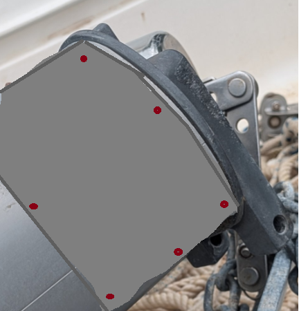

If you can't find a sleeve, SBO also sells the bracket that the spreaders sit in... you might be able to cut off the wings and use that as a sleeve.
Alternatively, if you have room above your sail to cut off the damage at the bottom.... and you don't want to mess with the rigging, you can add that distance back in the form of ablock of trex or Starboard that you place under the hindged mass foot. As mentioned above, that might compromise your mast raising system.

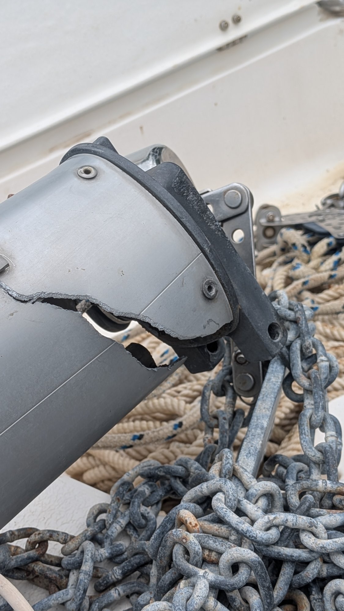

Or... repair this one on the cheap while you track down parts.
Drill out these rivets...

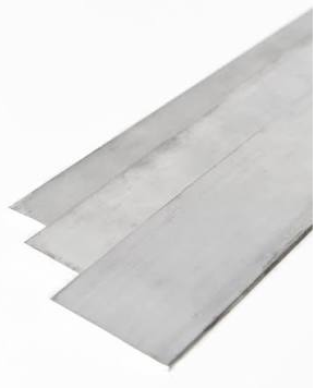

Take a large channel lock and gently bend the torn part back into alignment. Put masking tape on the back side of the gash then JB weld the gash. Next go to get some aluminum flatbar (hardware store)
Find a fence post or some other curved surface and with a rubber mallet try whacking the flatbar to match the curve of your mast as best you can. Cut off about 6" of the curved flatbar and fit it over the gash. Fill in any imperfections with the curved fit with JB weld. Let it set and pop in some rivets to secure it further. Replace the mast foot... go sailing.

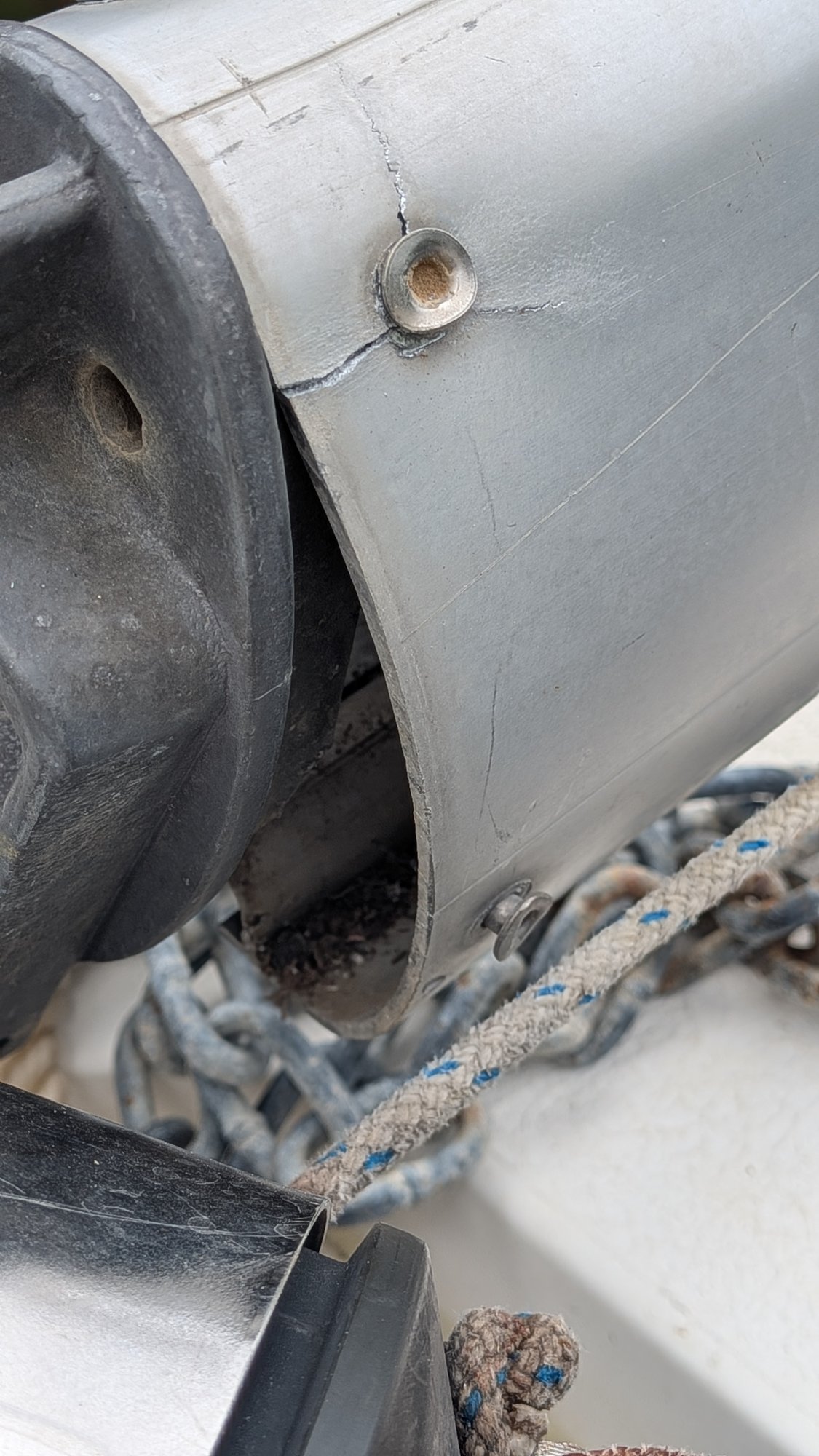

I did this exact same thing on my 23.5 last week, though the stay was used, but it popped/or fell out during the raise. It was ugly. I talked with an aluminum welder, and he was not confident that the aluminum would not become brittle after the weld. He suggested cutting the bad section off the mast and just re-adjusting the stays, etc. That is my plan for today, though I think I only need to cut about 1.5 inches off.

Instead of adjusting the stays, just add the same width of a block under the mast foot. Use something like starboard or some other high density polyethylene block.

I ended up cutting just over 1.25 inches off the mast, enough to have to remove the plate over the lifting pole. My cut wasn't completely symmetrical, so I need to go belt-sand the mast base to square it up. I really do like the idea of using a piece of starboard, or two, to sit under the mast base to minimize the geometry change.
