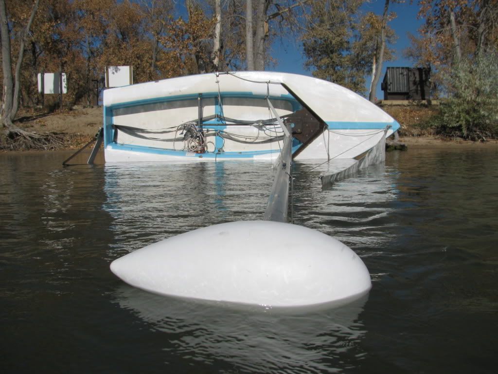

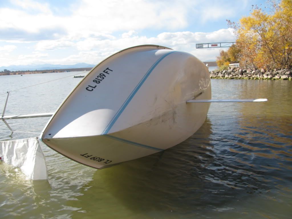

This is a 15 foot "not self righting" boat being tested with the Hobie float
I put this on after getting the mast stuck in the mud (turtle) on a chilly late fall day. After putting on the float, I havent flipped this boat again while sailing but Im pretty sure Im not going to turtle again and the float makes it very easy to upright the boat. The float also insures that water cant get into the inner hull (which destroys the boats stability) due to the end of the mast sinking too much.
Most of the cats that use these have rotating masts that orient the float with the apparent wind but if your putting this on in the first place, that may not be important to you (didnt bother me much)..

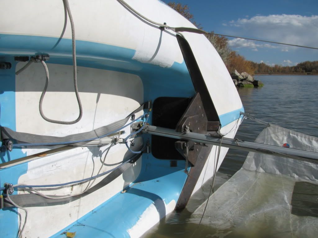

In the attached picture (which has a float holding up the end of the mast) you can see an access cover just in front of the mast and when I flipped this boat, the mast immediately sank enough for the water level to get to the access cover - which of course is not at all watertight. When the inner hull has water in it, the boat has almost no stability. Even if you get the mast back up with any sail at all, the boat will just go right back over.
I think the racing guys without floats are just good at getting the boat back upright very fast.
