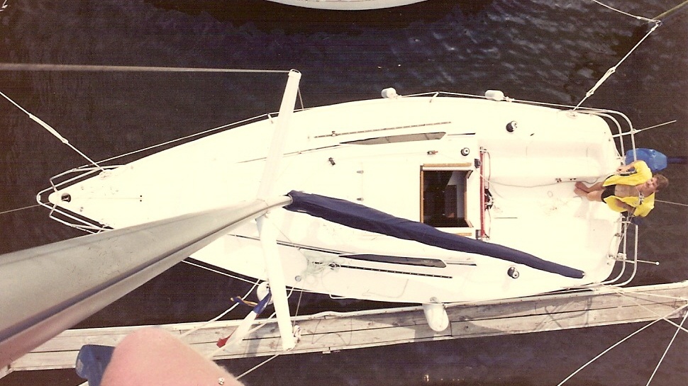

Back when my 26.5 was in the water, I went up the mast twice. First time to install a VHF antenna and cable, second time to install a spinnaker halyard crane and block. I'm a little under 200 lbs. and I felt safe going up. We used the main halyard on the bosun's chair and kept the jib halyard shackled in for safety. Closely Inspect your standing rigging and halyards before you go up. I also tied another line from the chair to the masthead while I was up there working.
