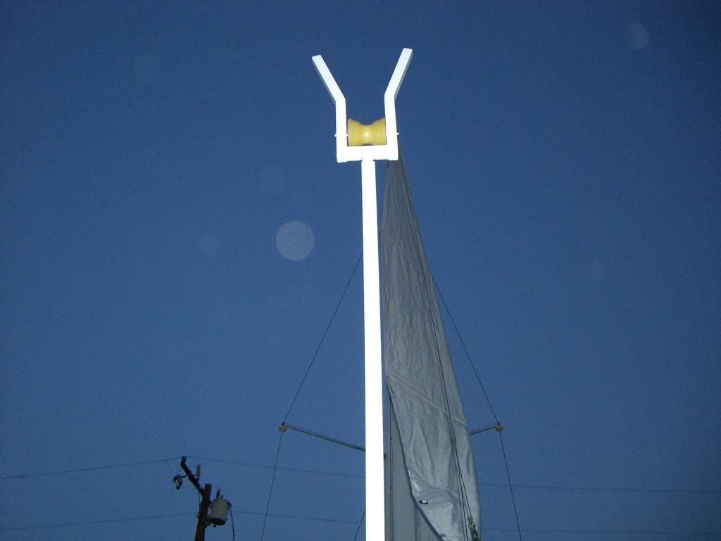

Here is the one I made up--
and do not forget to add a bar accross the bottom to keep it from twisting.

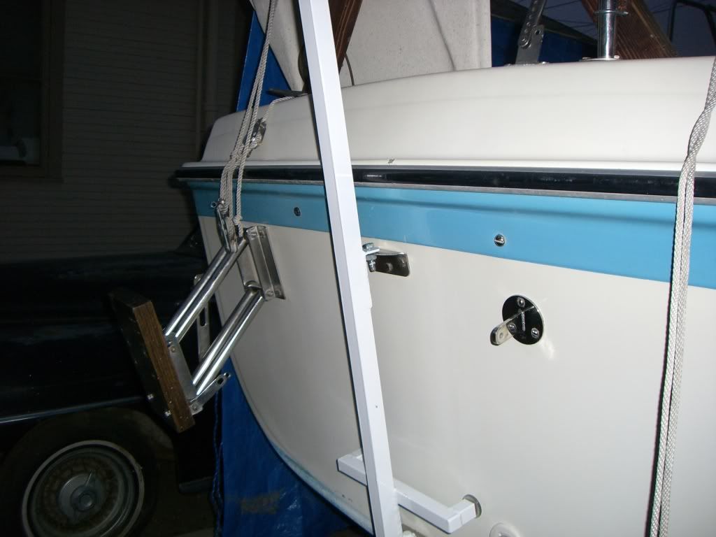

Here are some pictures of the stock support that I modified. Mounting on the gudeons is not very convenient.

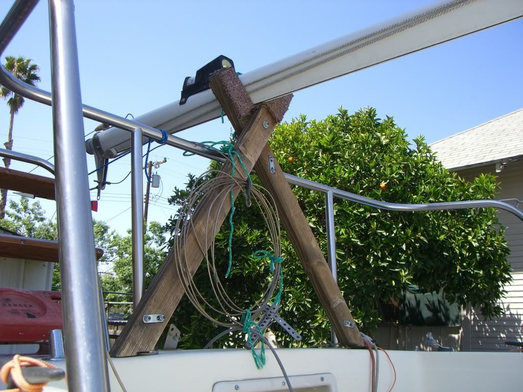

Here are pictures of the mast crutch on my neighbors boat. If I were to make it I would make it taller. I especially like the way it rest on the transom but notches onto the rail stanchions. A simple bungee will keep it attached to the rail at the post notch. A little wider notch and a plate would hook onto the rail and stabelize it that way, no bungee would be needed.
