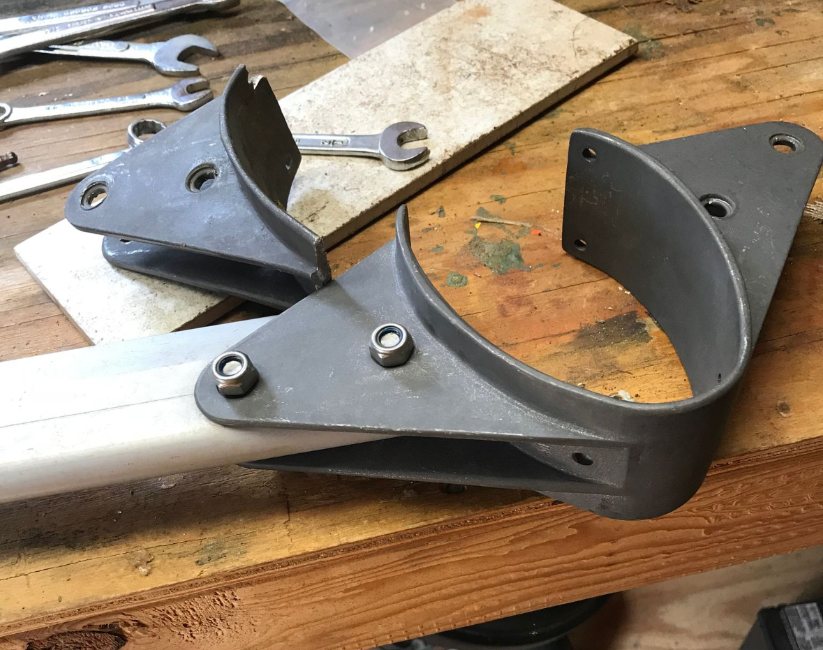

There is a sleeve that fits over this mast that is used to house the spreaders. I’ve attached a picture of one that I purchased right here at the SBO store. Slip this over the bottom, cut off the ears and rivet it in place and you will have your overbuilt mass base repaired

There is a sleeve that fits over this mast that is used to house the spreaders. I’ve attached a picture of one that I purchased right here at the SBO store. Slip this over the bottom, cut off the ears and rivet it in place and you will have your overbuilt mass base repairedView attachment 233560
On second thought, don't cut off the ears... instead, put a shackle with a block in them and you can run flag halyards up the mast....

Yes, it is the Kenyon Isomat with the very strange foot and base. I had planned anyway to change to the new design, and I was able to find a used mast locally from another chap who's boat was sadly no more. So now I have two masts, and have been looking for a good fabricator. While I do like the idea of using the spreader ring as a flag halyard base, I also don't want to catch my ankles on those ears.
