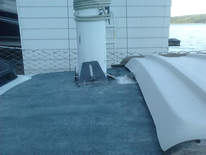

Im looking at a 1979 hunter 25,i like everything about the boat but the compression at maststep. Is a little compression ok,can i enjoy a few years of sailing without concern before i tackle the project of repair.

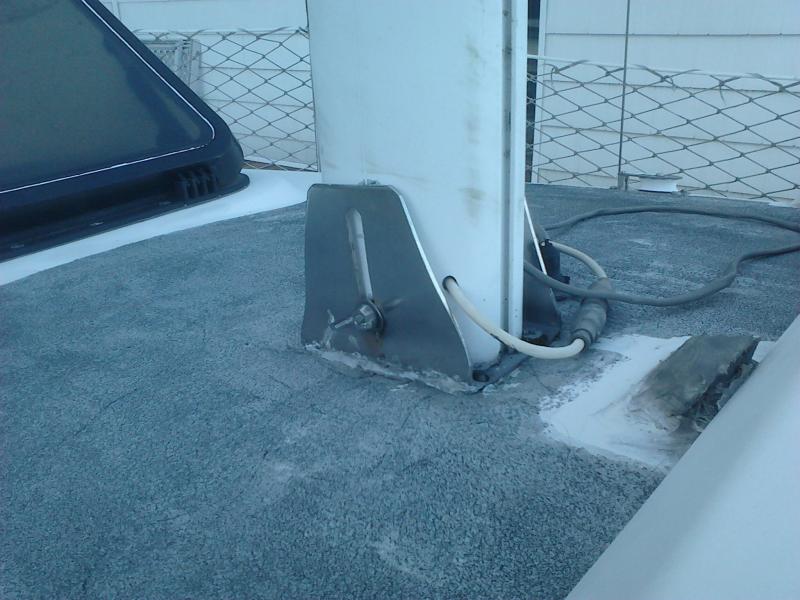

In the one picture you can see how the mast step compresses more toward bow which i believe is a result of back half of mast step resting on a post that is part of the bulkhead.the door still rolls freely but you can see the forward compression in front of the post. also noted some seperation of the bulkhead from roof on starboard side but portside has no issues..
anyone have same issues and still sail? should i stay away from this boat?

Jam a "post addendum" in there, 'til you get around to fixing it proper?

When I was looking for a boat, I came across a similar situation and the boat surveyor recommended that I walk away; there are plenty of fish in the sea
The owner recently had the standing rigging replaced and it was unable to with stand the proper tension.

thanks for the input guys am leaning toward the walk away advice,but price and overall condition of boat has me on the fence

We had a total rebuild of the mast step on our '77 h27 done for around $1,100 at a good fiberglass shop. With an aluminum plate instead of balsa core, the fix is certainly better than the original. If the rest of the boat is sound, consider getting a local quote, and asking the seller to take the repair off the price.

Is a little compression ok,can i enjoy a few years of sailing without concern before i tackle the project of repair?
No. Indentation of the deck shows the support system underneath the step has failed. Sailing this boat as-is will only cause more damage. Ultimately the deck may crack in a hundred places.
You are in luck, however, because this problem is not hard to repair. It is most likely due to water danage to the balsa core under the deck. Most of us encounter this on this vintage of boat. Anyone using even minor tools and a bit of know-how can do it. I recently posted this procedure on my boat blog. It might be worth your time to read it.
If the compression post has failed, it needs to be replaced. But if it is sound and only the deck is dented in, it's almost surely deck-core rot which is what can be easily fixed. The compression post is not hard to make at all. I made mine out of beautiful white spruce, laminated in epoxy, varnished with Captain's, and it's fine. I shimmed the top using bits of Formica (which does not crush, so it's perfect for compression-post shims). There's nothing wrong with that.
One (light-hearted) caveat, however. It has been said that when dealing with a private seller, you should always bid low on the bicycle with flat tires or the guitar with missing strings. These are the easiest problems to solve though many sellers think they are a major hassle (and maybe the reason they are selling). If you truly like everything else about this boat, I say bid low, get it and fix the deck. You'll have gotten a terrific model of boat at a bargain and you'll get to learn how these things can be remedied and thus feel like a pro.
Here is the link to my blog--
http://dianaofburlington.blogspot.com/2012/05/jcs-secret-system-for-filling-deck-core.html
Try it out. If you have questions, e-mail me :)
