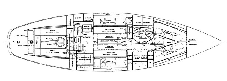

I must stress that whilst my boat does of course move a little in places (which boat doesn’t?) – none of them worrying – there is certainly no sign of untoward movement in the mast-thru-deck area. The Neoprene wedges were originally popping out because they were just v'd wedges, without a rebate to hook over the collar. I believe that these early Alden GRP boats were well specified and built very strongly in this area. On my Caravelle I can always open and close the WC doors with ease when very hard pressed: that was one of the first things I checked during my pre-purchase test sail. See the attached accommodations plan, showing the very neat arrangement of WC doors around the mast devised by the Alden office, which takes up less saloon space than the traditional side facing door, whilst hiding the mast and presumably offering a lot of stiffness at a crucial position. It also makes the forward cabin semi “en suite” - as long as one remembers to lock the other heads door when in!
