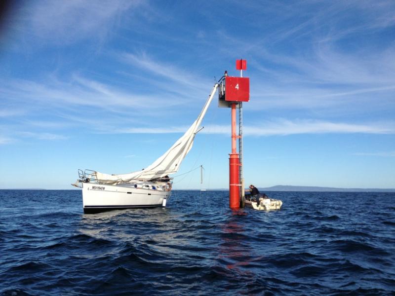

Managed to hang a shroud on a channel marker in our B393 couple of years ago. fortunately the mast hung up on the piling till the rescues boat (with wire cutters) cut it free and we put the mast rigging sails etc overboard.
total cost (insured0 $A 60,000+)
silly mistake on my part I was unsighted by the jib, didn't allow for the tide, no excuses it was only 10kn of wind.
But no one got hurt and lesson learned
