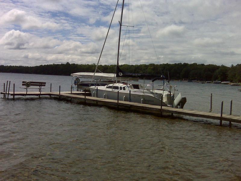

For all to see, here is a picture of the boat. Not the greatest, but all I could dig up.

Thanks for the pic.
From what I can see (masthead not visible) the prebend looks a little large AND the rake also a little too much.
However, as the B & R rig relies on prebend I would tend to go on the basis of how the mainsail looked when hard on the wind (and reaching) - AND whether the boat was 'hard mouthed' when beating.
As a starting point the previously stated 1% prebend is a useful guide or 4" in your case (30' luff length).
Also 4-6" of rake is a good initial setting.
Now, if the turnbuckles are within a turn or two of coming apart then either something is amiss with the setup or the rigging lengths are wrong.
Presuming the mast is original and unmodified, then perhaps a tape measure on the wires in question (mast up) would enable comparison with the quoted lengths. Sadly I can no longer locate the table of Hunter standing rigging lengths but I would imagine Hunter Support or a rigging specialist could oblige.

From the look of the mainsail it could do with a bit more bend - if the mast could take it!

Thanks for the web site with the H240 picture. The mast actually looks a lot like my sailboat so perhaps I am fretting over nothing. I can imagine that a raking can give the illusion of too much bend so I will look at that when I step the mast in the spring. I will also use the suggested trimming steps. Thanks everyone!
