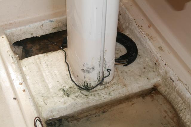

I have a O'Day 30. The mast has been replaced at some point and I seem to be having a leakage problem at the base of the mast inside the cabin.
Where the bottom of the mast sits to the left and under what looks like the fiber-glassed bridge the mast sits on underneath this I have around 3-4inches of water seeping in with a 24 hour period. Would I need to cut out this area out to get underneath it or could I simply fill in the hole which you can see to the bottom left of the bridged area. This goes right through to the other side so to as to let water come from the Head area where the shower is and enable water to go into the bilge. We don't use the shower so I'm not worried about filling in the hole.
I may have to wait until the boat is on the hard and look up through the center board to see if there is a problem.
Just out of curiosity is the base are of my mast normal?
