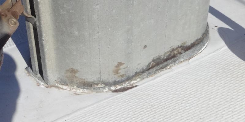

I have been noticing the slow spread of corrosion at the base of my mast. A rigger told me I had water inside and that I should drill holes to drain out the water which I did over a year ago. I am planning to step the mast this summer and get a closer look. At that time I will seal any leaks on the mast. I will order a new mast "boot" from Catalina. But I'm wondering if anyone else has dealt with this problem and what you did? Will I need to grind off the corrosion at the bottom to even it out?? I attach a picture which also shows that the mast seems to have "sunk" into the deck more forward. Any experience on this issue would be appreciated. Thanks, Jim

im not familier with the boat, but it appears to be a deck stepped mast.... so there should be a mounting plate under it....
in my opinion, the plate sinking into the deck is more of a concern than is the amount of corrosion you have gong on.
I would bet the rigger is correct and there is quite a bit of water in the mast... this would easily explain the sinking mount.... water intrusion thru the retaining bolts and rotting the core.
that will need to be fixed as soon as possible to prevent further damage....
the mast should have had drain holes/slots in it before it was stepped originally, but sometimes people think the water will drain out thru the cracks.
this is true for a new assembly that has not has time to accumulate debris and corrosion, but after a few years the accumulation can effectively dam the escape route for the water and leave you with a problem that will eventually show up... and you have the photo to prove it.
unless it is a keel stepped mast, DONT use a mast boot.... for a deck stepped mast you want the area to have open drainage and ventilation.... inside and out.
a certain amount of water IS going to find its way into the mast, there is no getting around that... so the only fix is good drainage..... ventilation will be a natural occurrence if there is a hole at the bottom for drainage and a way for air to escape at the top.
get the mast off the base, clean away the debris and sediments that have dammed the drainage, install a more permanent and active rather than passive drainage route, and deal with the corrosion in what ever manner you choose, BUT ONLY AFTER reading about corrosion on aluminum..... because sometimes is better to just allow it to dry and leave it alone rather than grinding off the protective layer that it has created for itself.
but letting water set against it (inside) as it is now, is bad, bad, bad....

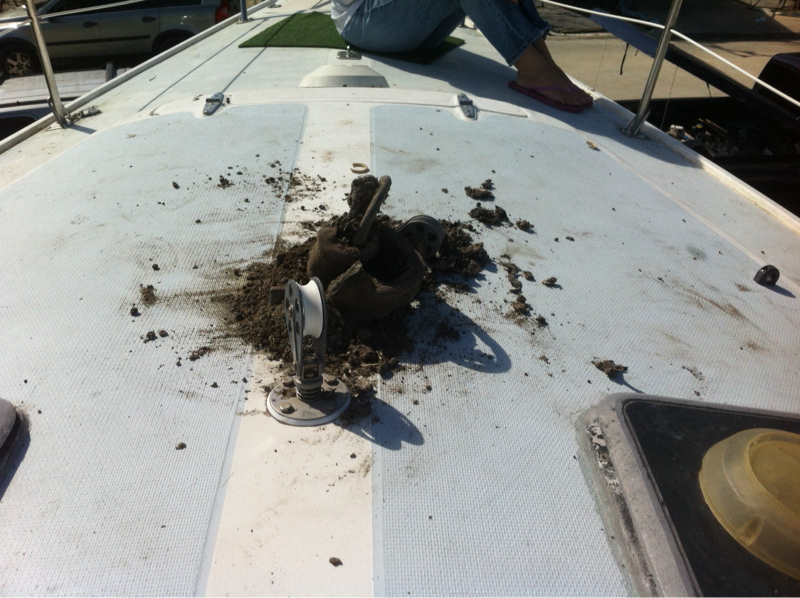

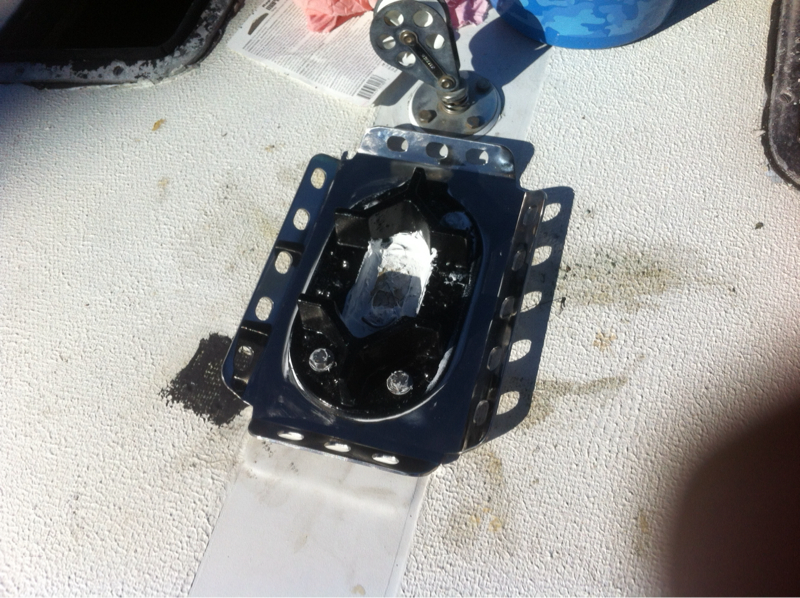

You will be surprised at the amount of bird droppings that will come out of your stick when pulled. I just had my old step recoated added a plate underneath. Neither were that expensive.

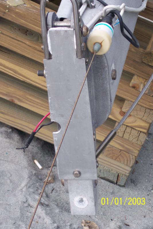

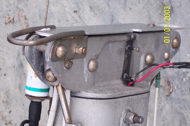

About closing off the mast top, here's a look at whet I did. Later on, I can go over what I did at the mast step for sealing wiring, step plats & vent drying.
