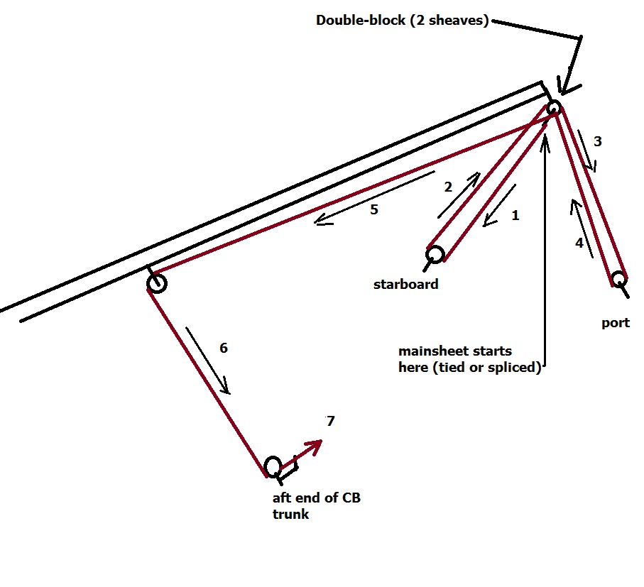

Basically, all the smaller O'DAYs were rigged more or less the same as the MARINER at that time, Starting in 1974 the Mariner, Day Sailer and Javelin switched to a mid-boom mainsheet. However, prior to that the mainsheet was rigged something like the below DS II drawings.

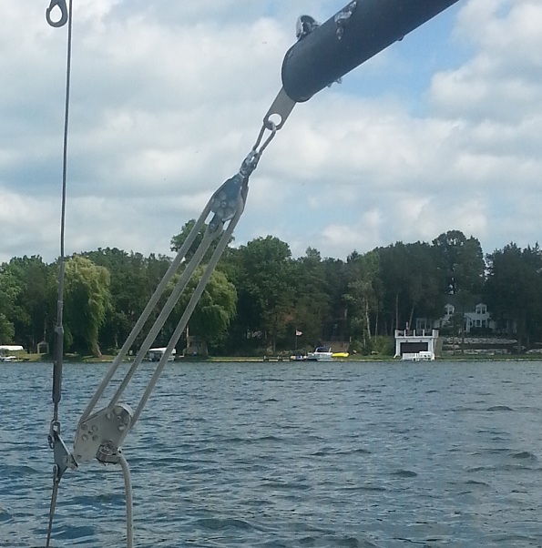

O'Day Javelin Barnegat Bay, LBI
thanks Sunbird - that's what I've currently got, as per the late 60s rigging instructions for the Javelin, but I"m finding (esp. when on beam or broad reach, the outboard interferes with the lines) so I'm trying to switch to mid-boom, which O'Day introduced for the Javelin in the 70s. The block on the boom and the centerboard housing are different than what I've got so I'm trying to figure out what I need to buy. I'll keep digging around. Fair winds this weekend, all.
