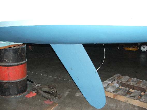

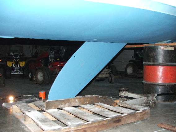

Mariner CB weighs 165# and his is stuck UP, it won't go down. See pic below of Mariner CB, usually no shackle.
