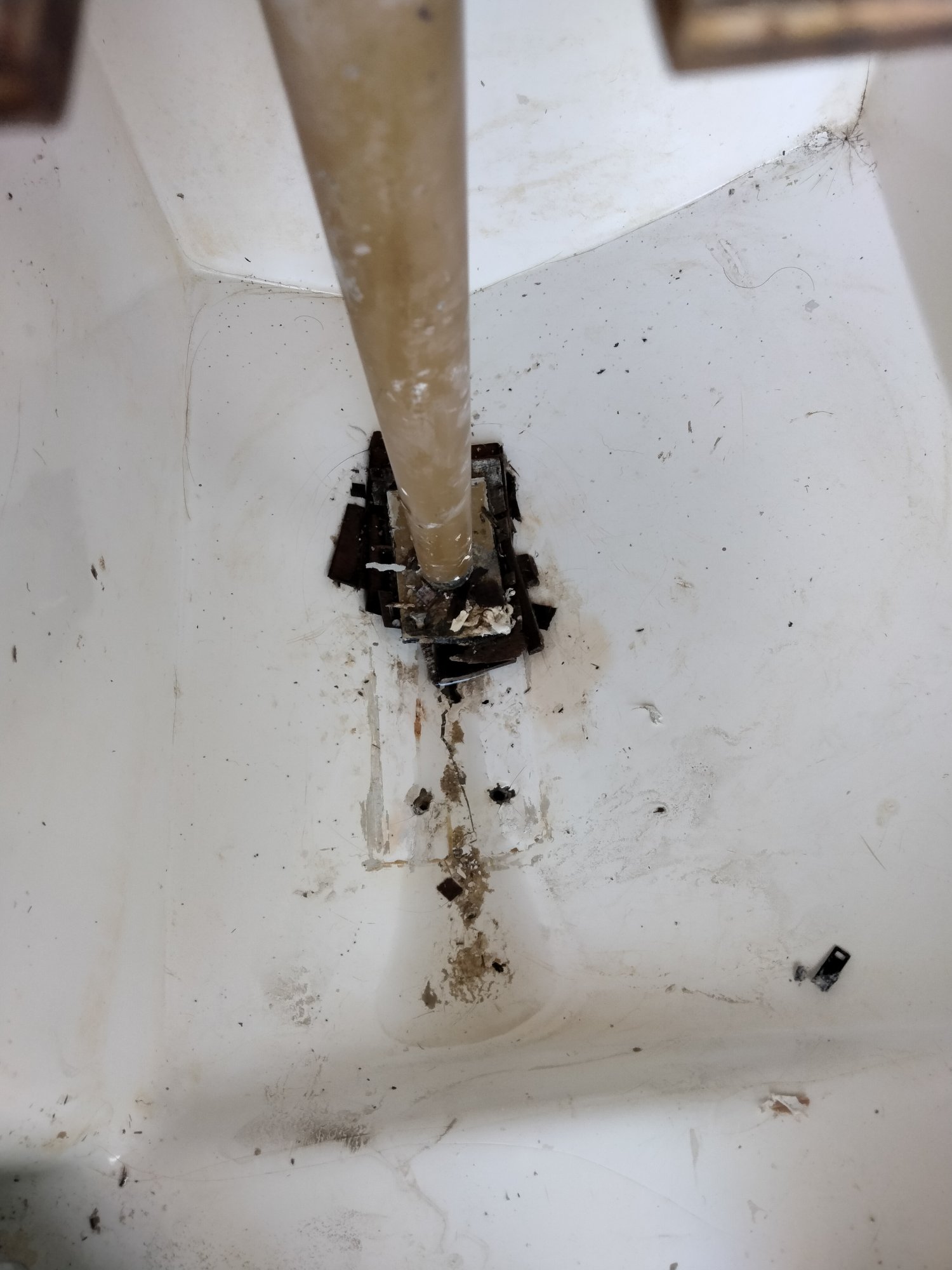

Hi. Just bought a 1976 Mariner 2+2. She looks in good shape but I would like to know what I should look for a boat of this age ?
Also, I have some water at the base of the mast support in the cabin. The piece of wood between the support and the hull is totally rotten.
  • Could the water come from there or is it another reason?
  • Any specific information about the size of this wood to be replaced?
Thanks for coop.

If your compression post is made of wood, it probably isn't original. The water is unlikely to have come from the base of the post. It may have run down from a leak around the tabernacle. It could also be settling in the area around the post from sweating moisture coming out of saturated floatation under the 'V' Berth or blowing into the foredeck air scoop, or even the bow hardware.
My compassion post is made of 1" metal, I assume stainless, tubing. It shouldn't require a lot of strength, 1" to 1-1/4" white oak or yellow pine should suffice.

Regarding the compression mast, I’ll proceed to replace the part and let you know if I have any problem.
