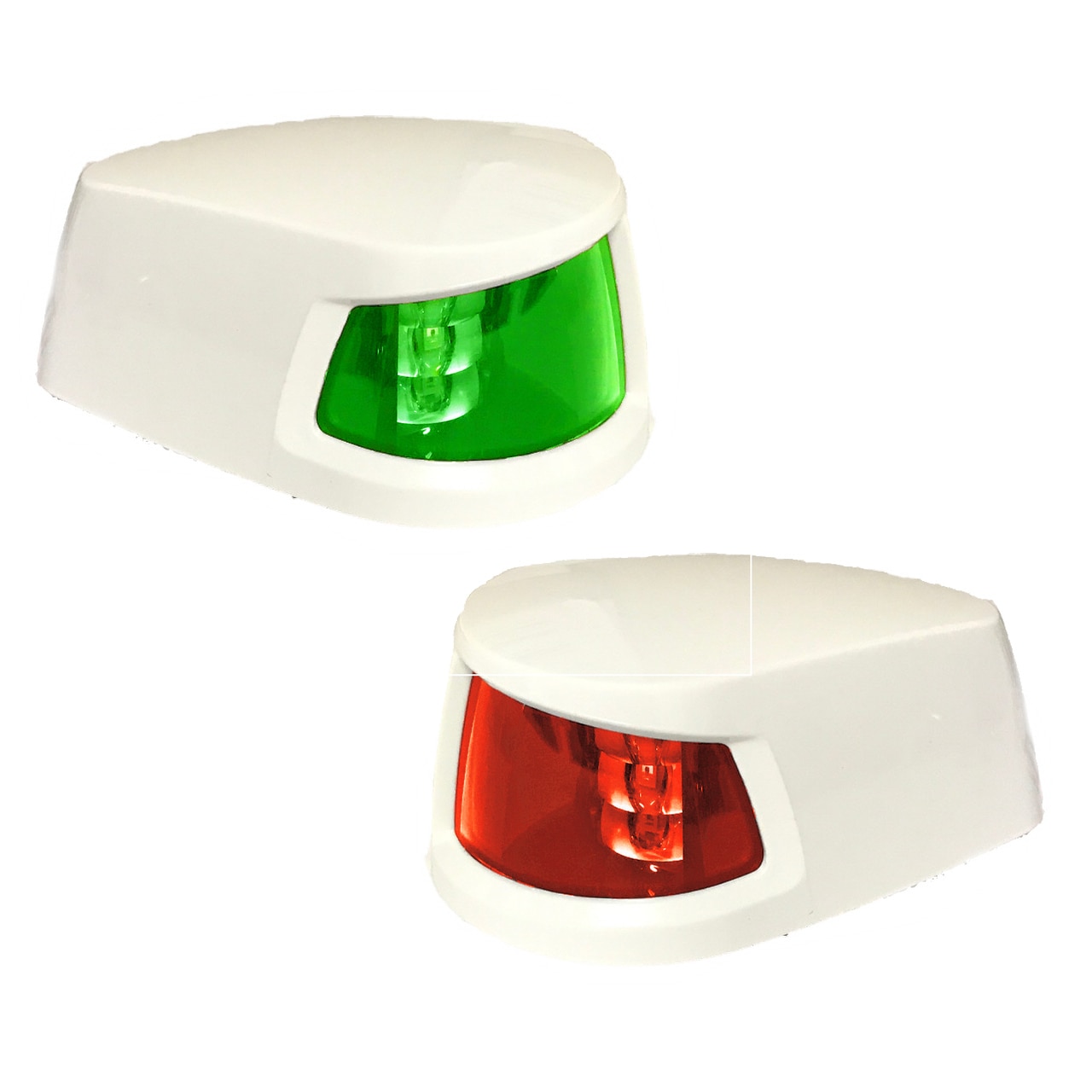

Last fall I installed new bow lights.
Bright compact install and USCG qualified.
Still looking for a stern light that will last.
