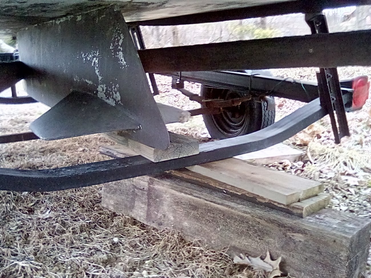

Hi. Newbie here looking for advice/experience using Marine Tex. I've got some damage to my keel wing. Is this the right product to use? Thanks.

I think that if you were to add a photo of the wing's damage you might get a better response. A photo will help determine exactly what needs to be done. I hope you have experience in glassing otherwise you might want to seek a professional. Some DIY stuff is OK, but you are dealing with your keel. Lose that (the keel) and you lose your boat.

The big question is how was the keel damage? That will determine the nature and extent of the repair.
Photos and type of boat will be helpful.

Please take some pictures from a few steps back and up close of the damage. The sailors here look not only at the obvious dents, but also what may have occurred further away from the 'ding' that grabbed your attention.

My boat is a Seaward 17. Photos of both sides of the keel are attached. Thanks for your advice.
That's a pretty good bite out of your wingtip. I think, since the repair is structural, you will need to build up a good base and then cover and fair the repair with epoxy, maybe West System or Totalboat. I have used Marine Tex, but mostly to repair cracked engine blocks, etc. It is a very hard epoxy, suitable for drilling and tapping.
I'm not sure about the best way to rebuild the wingtip. You might be able to grind back the surface of the wing a bit and use fiberglass to make a new tip. A call to West Systems might be helpful.
13,992
Marine Tex is definitely not the product for this job. Any resin, epoxy or polyester is very brittle until something is added to give it strength. Fiberglass acts like reinforcing rod in concrete, it adds strength and flexibility.
It will be necessary to grind off all the damaged glass with with a 12:1 bevel to solid glass, then build the area up until it is the right thickness. It will probably be best to build up from the bottom and down from the top so that the good part of the wing is sandwiched between layers of new glass.
Don't bother trying to match the edges when laying up the glass. After it cures just grind the corner in shape. You'll want to be close, but an angle grinder will be your friend here.

I would contact west systems and ask there tech support for repair advice. Whatever you use you are going to have to remove all of the paint from the damaged area before you make any repairs.

First I would clean up the other wing. Then make a cast of that wing so I have a form for fitting the other wing. After cleaning up the damaged wing, attached the form so you can pour in the new resin. Now, that is me and I have no clue of how to repair fiberglass, but at least I have a concept of how to proceed. Crazy? Probably. LOL

Have you condsidered Calling Hake yachts and ask them how they made the wing and what they recommend as the best way to repair the damage?
