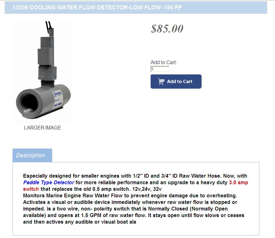

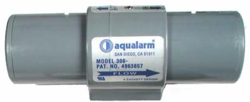

This will ensure a continuous water flow to the condenser:
Connect it to an audible alarm or go the whole nine yards and use an interlocking relay for a shut down of the A/C.
