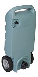

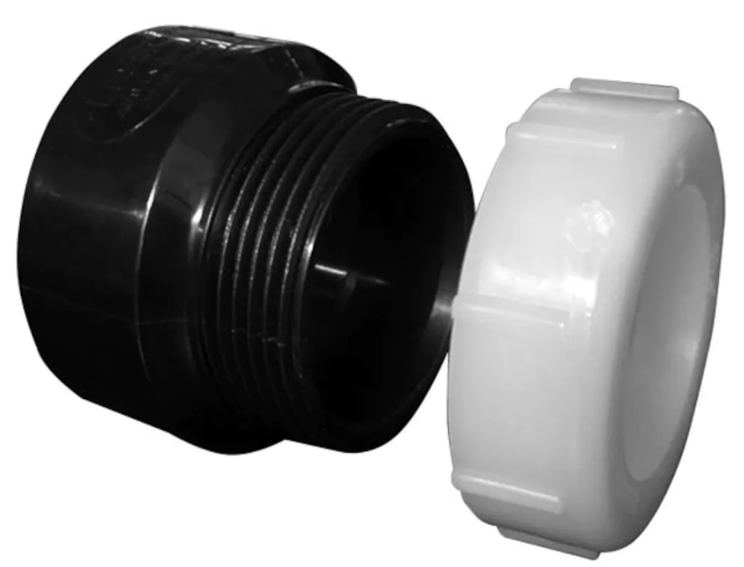

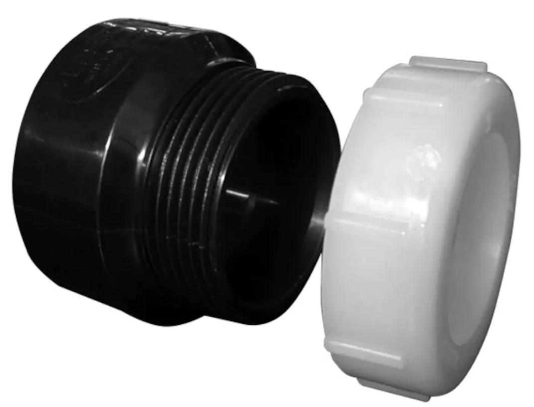

Assuming your pump has the appropriate lift you should be able to make an adapter to screw on to the deck pump out fitting and give an air tight seal. You can then connect your tubing/hose to the adapter in a way that will again give an air tight seal. You should then be able to pump it from there where ever you need it to go.
I made an adapter using standard household abs fittings that I then have connected to either a macerator pump or a whale diaphragm pump using suction hose. Outlet from either can be pumped into a container of your choosing. I used a rv portable waste tank that I could then empty into a toilet. (You may need to prime the pump - particularly the macerator)
For the deck pump out fitting I used a abs trap adapter - don’t remember if it was a 1-1/2 or 1-1/4” and used it with 1-1/2 abs pipe - you could do with pvc as well. If using a macerator pump you can use a garden hose to transfer to the final destination.

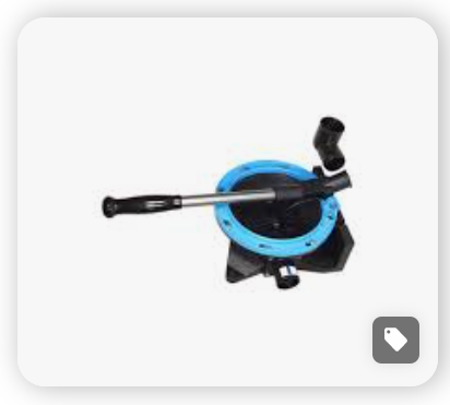

I know nothing about your boat's holding tank.. size, location or installation details. But, if it is as simple as my Cat 27's... a rectangular plastic box with requisite access for hoses and a large one for cleaning... it can be removed pretty easily. So.. I suggest you add that option to growing list of suggestions before you go spend a lot of money on special pumps or tools.
That said, if I felt compelled to purchase a new tool, I would want add a nice hand operated bilge pump that you can use if you find yourself in an area that doesn't have pump out service. The diaphram pump Ralph Johnstone pictured is really nice. Rotary pumps are even more powerful and work quite well when mount on a board that can be slipped into the hatchway slots. Manual operation rather than electric is the key feature.
