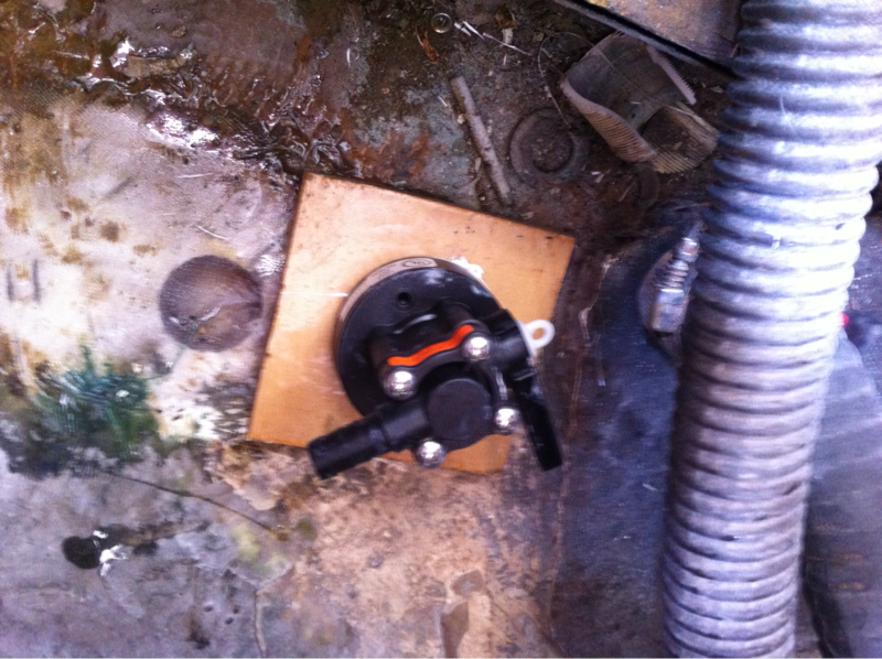

That could work fine, I was locked into thinking the elbow needed tightened down all the way.... What sealing compound should I use on the elbow to secure and seal it half a turn before tight?
BTW, I've only gone hand tight so not too much risk of breaking anything...
almost any of the stuff that is used on gas line fittings... like you can get at the hardware store.... it is thick when it goes on, and in time the carriers will evaporate out a little and it will get even thicker and will set the fitting so it will take a wrench to remove it in a few months.
i would steer away from the liguid teflon as it isnt as thick...

In my school summer holidays many, many years ago, and when I was working as a plumber's mate, it was our standard practice to get a fitting tight and at the correct orientation was to use a "back nut". This is a thin nut you wind on to the stationary fitting to begin with. Then coat the male thread of the fitting liberally with sealant and screw the other one on and to the required angle. Then wind the back nut back until it locked against it. This way the elbow should be sealed AND resist turning and so stay sealed.
All that was in 1953. Things might have changed since then though!.
Regards.
